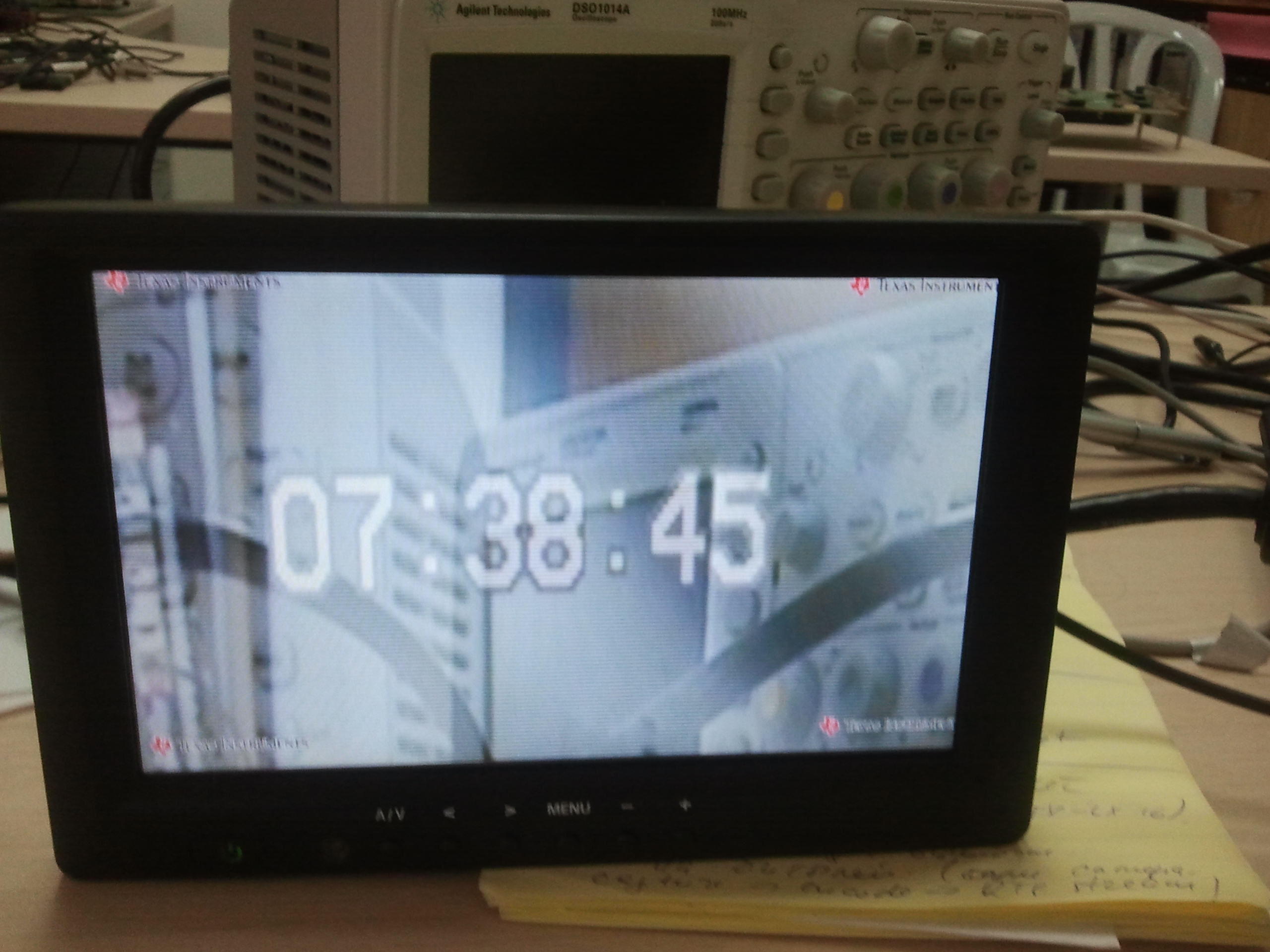

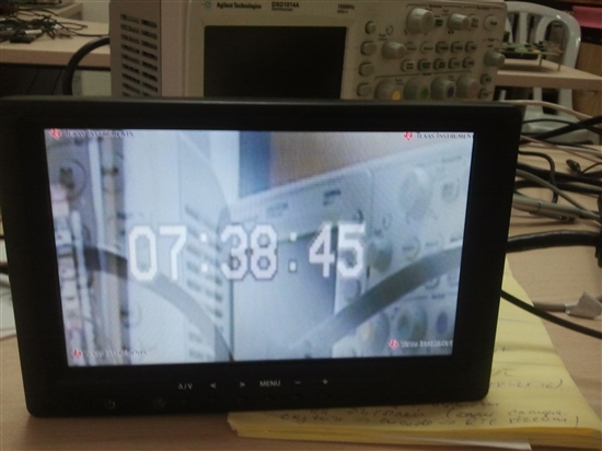

Mistral DM8148 EVM and TVP5158 video security board from Spectrum Digital
Other Parts Discussed in Thread: TVP5158
    CaptureLink_CreateParams_Init(&capturePrm);
    capturePrm.outQueParams[0].nextLink   = gVcapModuleContext.nsfId[1];
    capturePrm.numVipInst                 = 1;
    capturePrm.tilerEnable                = FALSE;
    capturePrm.numBufsPerCh               = NUM_CAPTURE_BUFFERS;
    capturePrm.maxBlindAreasPerCh         = 4;
    pCaptureInstPrm                     = &capturePrm.vipInst[0];
    pCaptureInstPrm->vipInstId          = (SYSTEM_CAPTURE_INST_VIP0_PORTA+
                                          vipInstId)%SYSTEM_CAPTURE_INST_MAX;
    pCaptureInstPrm->videoDecoderId     = SYSTEM_DEVICE_VID_DEC_TVP5158_DRV;
    pCaptureInstPrm->inDataFormat       = SYSTEM_DF_YUV422P;
    pCaptureInstPrm->standard           = SYSTEM_STD_MUX_4CH_D1;
    pCaptureInstPrm->numOutput          = 1;
    pCaptureOutPrm                      = &pCaptureInstPrm->outParams[0];
    pCaptureOutPrm->dataFormat          = SYSTEM_DF_YUV422I_YUYV;
    pCaptureOutPrm->scEnable            = FALSE;
    pCaptureOutPrm->scOutWidth          = 0;
    pCaptureOutPrm->scOutHeight         = 0;
    pCaptureOutPrm->outQueId            = 0;
    for(i = 0; i < NUM_CAPTURE_DEVICES; i++)
        vidDecVideoModeArgs[i].vipInstId        = SYSTEM_CAPTURE_INST_VIP0_PORTA+i;
        vidDecVideoModeArgs[i].deviceId         = DEVICE_VID_DEC_TVP5158_DRV;
        vidDecVideoModeArgs[i].numChInDevice    = 4;
        vidDecVideoModeArgs[i].modeParams.videoIfMode        = DEVICE_CAPT_VIDEO_IF_MODE_8BIT;
        vidDecVideoModeArgs[i].modeParams.videoDataFormat    = SYSTEM_DF_YUV422P;
        vidDecVideoModeArgs[i].modeParams.standard           = SYSTEM_STD_MUX_4CH_D1;
        vidDecVideoModeArgs[i].modeParams.videoCaptureMode   =
                    DEVICE_CAPT_VIDEO_CAPTURE_MODE_MULTI_CH_PIXEL_MUX_EMBEDDED_SYNC;
        vidDecVideoModeArgs[i].modeParams.videoSystem        =
                                      DEVICE_VIDEO_DECODER_VIDEO_SYSTEM_AUTO_DETECT;
        vidDecVideoModeArgs[i].modeParams.videoCropEnable    = FALSE;
        vidDecVideoModeArgs[i].modeParams.videoAutoDetectTimeout = -1;
    Vcap_configVideoDecoder(vidDecVideoModeArgs, NUM_CAPTURE_DEVICES);

[ti_vsys.c.246] gVsysModuleContext.vsysConfig.systemUseCase = 0
Lets check platform defined ...
Will be selected usecase for TI_814X_BUILD
********* Entered usecase 4CH <814x> Enc/Dec OSD Enabled SCD Enabled
 3394: MCFW  : CPU Revision [ES2.1] !!!
 3394: MCFW  : Detected [UNKNOWN] Board !!!
 3394: MCFW  : Base Board Revision [REV A] !!!
 VCAP: DEVICE-0 (0x58): Chip ID 0x5158, Rev 0x0002, Firmware 0x0000 !!!
 VCAP: DEVICE-0 (0x58): Detected video (720x288@50Hz, 1) !!!
 TVP5158: 0x58: Downloading patch ...
 TVP5158: 0x58: Downloading patch ... DONE !!!
 TVP5158: 0x58: 5158:0002:0302
Vcap_deviceCreate (0xbe9a8ae4, 1) return 0 [ti_vcap.c.1797]
 [m3vpss ]  20086: CAPTURE: Create in progress !!!
 [m3vpss ]  20124: CAPTURE: CaptureLink_drvCreateInst (2d86c9d0, 0) [links_m3vpss/capture/captureLink_drv.c.1195]
 [m3vpss ]  20124: CAPTURE: TVP5158 selected [instId = 0]
 [m3vpss ] >>>>>>>>>>>>>>>> 20125: CAPTURE: TVP5158[0] set mode/standard: 515 <<<<<<<<<<<<<<<<<<<<<
 [m3vpss ]  20125: CAPTURE: VIP0 PortA capture mode is [ 8-bit, Pixel-mux Embedded Sync] !!!

Hello TI' teams.
I have a strange problem, when tried to capture D1 analog video with DM8148 Mistral EVM (base board only) and TVP5158 Video Security Board rev.C from spectrum Digital with 4 TVP5158 video decoders on board connected to the EVM.
My software platform is dvr-rdk version 3.5 from ud-works. Used mcfw-demo application supplied by ud-works, selected use-case - multich_progressive_4d1_vcap_venc_vdec_vdis.c
Captured video displayed on LCD display connected to HDMI output on EVM. Target display resolution - 1920x1080x50p. Lates TVP patch 02.03.02 uploaded successfully. Capture mode - 4 channels, pixel mux with embedded sync, via VIP0/portA. Display show only first channel - DEMO_LAYOUT_MODE_1CH layout used.
SYSTEM_USE_VIDEO_DECODER not defined, so TVP5158 video decoder serviced directly by application and not by m3/hdvpss subsytem. NUM_CAPTURE_DEVICE equal to 1.
Video decoder successfully detect input video signal: 720x288@50Hz, but video on display isn't loocked proper - you can see on attached image, first half of the line blended with second half of the line (oscilloscope shown twice on LCD display).
I guess the problem with VPSS data clock, but clock isn't directly managed by application.
Please help me to fix the problem
  • Can you enable file write in the demo and check the encoded file if it is showing the same artifact. This will help determine if it is capture side or display side issue.
  • Hello Badri,
    thanks alot for your reply.
    It's looking capture artifact. When I disabled channel 3 from demo' run-time menu:
    Run-time menu-> 1. Capture setting -> 1. Disable channel. (choose channel 3)
    video frames on LCD looks Ok.
    I forgot to write that I have only 2 physical cameras connetced to inputs 0 and 1 of TVP board (but TVP decoder works with 4 channel - mux mode). Channels 2 and 3 aren't connected.
    1) I don't clearly understood, why disable capture channel 3 from demo run-time menu fix the capture and display of channel 0?
    2) Please let me know what I need to change for correct displaing of all 4 video channels on LCD?
  • Pls attach the encoded stream for channel 0 and also "Print Detailed Statistics" output (Option "I") before and after disabling channel 3.
    Pls collect stats atleast 3 times with 1 min interval before and after disabling capture channel 3/
  • Attached detailed statistic info - before and after channel 3 disable from run-time menu.
    Interesting, when this channel [channel 3] re-enabled - video continue looks proper!!!

  • Log shows you have set 2x2 layout in HDMI and HDMI display is configured for 1080p60.Can you confirm this is expected setting.  Your original post indicates you have selected 1x1 layout and 1080p50 display.
    Do you see artifacts in SD display as well ? It should show 4x4 layout.
    Also rebuild usecase by seeting swmsPrm.outputBufModified = TRUE and check if you see any change in behavior,
    Can you attach the encoded stream for channel 0 to confirm issue is present in capture.
  • "Log shows you have set 2x2 layout in HDMI and HDMI display is configured for 1080p60... " - i tried to test with other display layouts: 2x2 - same problem. Only disable channel 3 fix the artifact.
