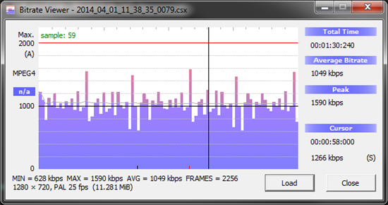

Here is the code i'm using to try and dynamically change the bitrate:
OMX_VIDEO_CONFIG_BITRATETYPE tBitRate;
OMX_INIT_PARAM(&tBitRate);
eError=OMX_GetConfig(pHandle,OMX_IndexConfigVideoBitrate,&tBitRate);
printf( "CURRENT BIT RATE IS %d\n", tBitRate.nEncodeBitrate );
//tBitRate.eControlRate = OMX_Video_ControlRateConstant; //OMX_Video_ControlRateVariable;
tBitRate.nPortIndex=OMX_VIDENC_OUTPUT_PORT;
tBitRate.nEncodeBitrate=value;
eError=OMX_SetConfig(pHandle,OMX_IndexConfigVideoBitrate,&tBitRate);
if(eError!=OMX_ErrorNone) {
		printf("Bit Rate Config Error %i\n",eError);
else {
		printf( "Bit rate changed to %d\n", value );
		m_nBitRate=value;
I call this every 300 frames at 30fps. I use a tool I downloaded called Bitrate Viewer to view the changes in bitrate. It looks like the bitrate changes are never applied.
Is there a setting I need to change to get this to work?
Steven
    Can someone at TI please respond to this. We need to rectify this issue for our customers.
    As an example I recorded at 1Mbps but tried to increase the bitrate by 100000 every 10 seconds. Bitrate Viewer shows that this did not happen.
    Steven
