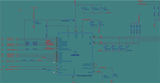

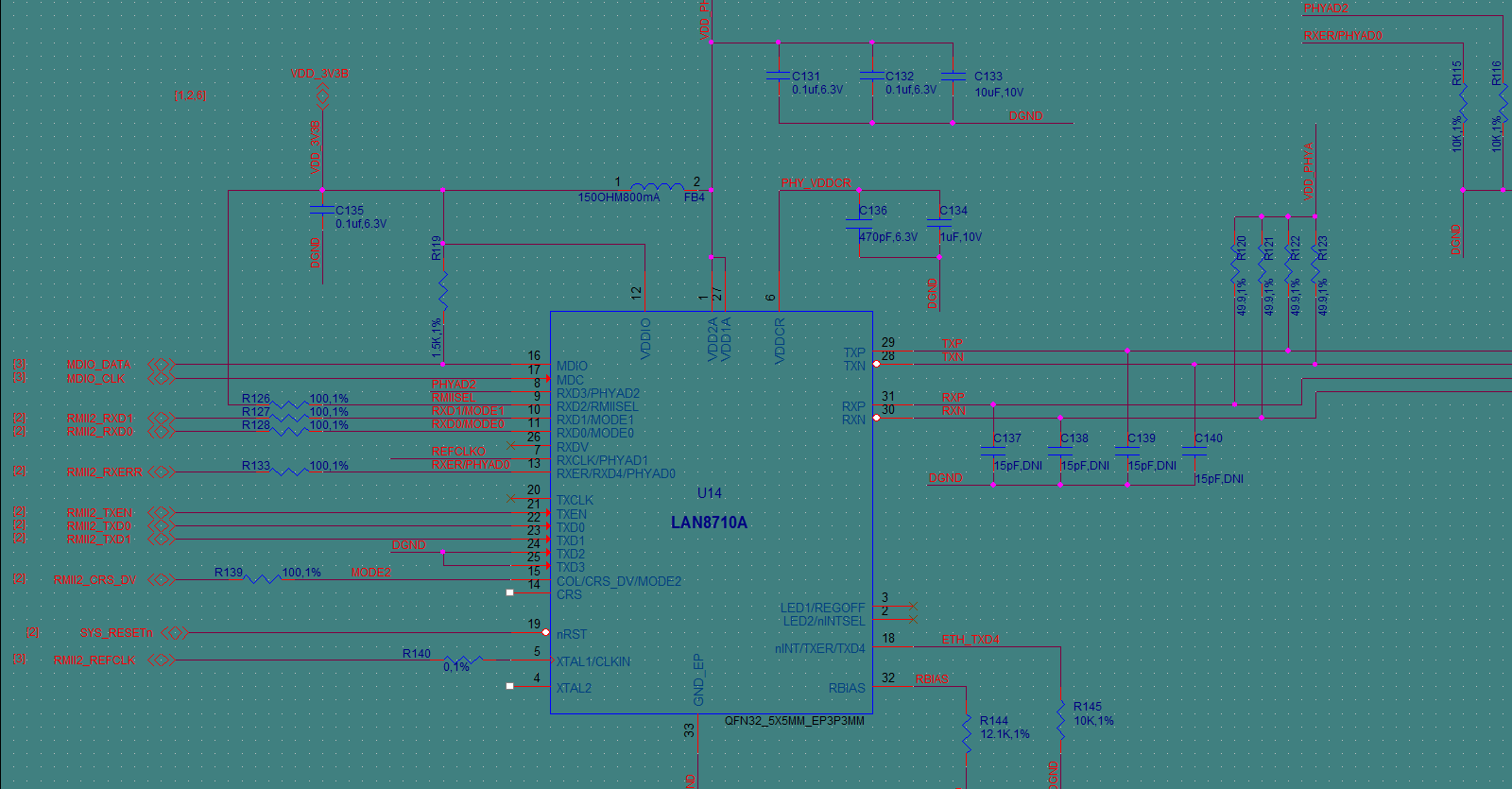

LAN8710A PHY on AM3359 through RMII2
Other Parts Discussed in Thread: AM3359
hi,everyone
I use a LAN8710A PHY connect am3359 through RMII2 ,I used the SDK06.00.00 is latest version,
I adjust the configuration in uboot and provide a external low jitter 50 MHz RMII LVCMOS reference clock to both LAN8710a and AM335x.
First I configure the gmii_sel register is 0x75,then configure the pinmux

I pulldown the PHY address pin,configure the phy_id like this
static struct cpsw_slave_data cpsw_slaves[] = {
.slave_reg_ofs = 0x208,
.sliver_reg_ofs = 0xd80,
.phy_id = 1,
.slave_reg_ofs = 0x308,
.sliver_reg_ofs = 0xdc0,
.phy_id = 0,

    Because of my negligence,the RMII2_CRS_DV signal   picked up fly line ,
    so it is longer than some of the other signal lines,what impact for the system work?
    thank you!

    This is my signal lengths:
    MDIO_DATA  590.19 MIL
    MDIO_CLK    568.99 MIL
    RMII2_RXD1  993.59 MIL
    RMII2_RXD0  893.98 MIL
    RMII2_RXEER 889.86 MIL
    RMII2_TXD0  816.85 MIL
    RMII2_TXD1  845.54 MIL
    RMII2_TXEN 829.94 MIL
    RMII2_REFCLK  996 MIL
    RMII2_CRS_DV  5730 MIL (this signal line pick up some fly line )
    I am surprise that I chose rmii2 interface, why it was displayed “link up on port 0” in uboot .I think it should show “link up on  port 1”, is it?

    Could you break down the RMII_REFCLK length? In other words, I need to know the clock source-to-MAC and clock source-to-PHY lengths.
    Thanks.
  • ok,DK
    I measured the length of their.
    The clock source-to-MAC lengths is 3870 MIL
    The clock source-to-PHY  lengths is 2938 MIL
  • I'm confused...where did the 996mils for RMII_REFCLK number come from in your earlier post?
  • Hi,DK
    I'm sorry I did not say it clearly.
    The day before yesterday I used AM3359 reference clock as the clock source output 50Mhz,but the PHY did not work.Then I knew I needed to provide a external low jitter 50 MHz RMII LVCMOS reference clock to both LAN8710A and AM3359.
    So I pick up a 50Mhz crystal through  fly line instead of the AM3359's clock .
    The 996mils is the RMII_REFCLK length from AM3359's pin to PHY's pin,and  it is not used now.
    The 3870mils is the length of clock source-to-mac being used now.
    The 2893mils is the length of clock source-to-phy being used now.
    Are there any problems for my clock signal length?
    Thank you!
  • I understand. I performed a quick analysis of your interface timing and I don't see a problem. Let's take a step back and look at more functional issues (like configuration)...
    Did you change the PADCONFIG for RMII_REFCLK to INPUT as suggested by Biser earlier in this thread?
    Did you configure the both the MAC (AM335x TRM section 14.5.7.2) and PHY (SMSC datasheet section 3.7.3) for RMII modes? Please provide the value of AM335x MACCONTROL register.
    Can you manually assign the interface an IP address, trying pinging an external address, and check CPSW_STATS (AM335x TRM section 14.5.4) to see if packet counters are incrementing?

    I pull the RMIISELconfiguration strap high with an external resistor R126 100Ω to 3.3V VDDIO,
    but I measure that The voltage of  the resistor R126 is 2.4V,this means RMIISEL pin only has 0.9V,should I use a smaller resistor instead of the 100Ω?
     I uploaded my profile board.c and mux.c and the picture of schematic.Can you help me look at my profile yet?
    Thank you.
  • The schematic seems ok, except this resistor R126. Try with a 1.5kOhm - 2kOhm resistor.
  • Hi,Biser
    I replace the R126 by 1.5KOhm of resistor,but it still does not work .
    I do not know where the problem happened
  • What is the voltage on RMIISEL with the new resistor?
  • Hi Biser,
    the voltage on RMIISEL with the new resistor is nearly 3.3V,
    I now have a question,how does the system dicide to use the interface of  rmii1 or rmii2?
    Thank you !
