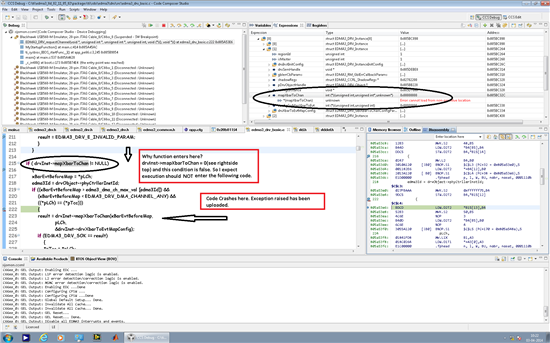

As I was using the driver for our EDMA3,
While using "EDMA3 request channel" API, The code is getting aborted from running.
Snippet of my main routine is attached. Can any body help? Requirement state: critical
LCH and TCC values obtained both are then seen to be 0 only if I see the values after the routine. I tried this out for region 0 and region 1.
What could be wrong?
regards,
Sijomon

    I found the code was getting aborted when it is going into an if statement "if(drv->mapxbartochan != NULL)"
    when checked,  drv->mapxbartochan which we get from the edma3open function is 0x000000;
    So it should not go into the if condition. But I found that was happening even if the condition is false.
    Then inside when that function is called, OS raises an exception and gets out of execution.
    please help

    The 'drvInst->mapXBarToChan' function pointer is set to be zero, before the request channel API is called. The 'if' condition which checks this in the 'request_channel' is going into the code, which is otherwise suppose to be skipped without executing it. But this is not what is seen. The image clearly conveys that, I think.
    I pulled out the code for this api alone and tried to compile it with my main code and tried to use it, of course with a different name, but then this particular issue became alright but got struck at a later stage, somewhere inside the 'resource_alloc' API which is a member of RM. I did not then go into the details of the exception.
    The structure is ensured to be intact which is verified and even visible in the screen capture.
    What can be done?

    2. You need to figure out what's going wrong with the pointer. The screenshot you're referring to is already to far in execution. You need to break earlier and check what goes wrong with the pointer.
    Kind regards,
    One and zero
  • Hi one and zero,
    I increased the stack size from 8192 to 16384 and tested, still the same problem.
    In the screenshot, I only intended to show that the if condition is ' wrongly ' executed. I took the screenshot at a point where the code was at a break point which I have placed inside the "if" condition. It is visible in the screen shot. But the drvInst->mapxbartochan, which is a function pointer, shown in the variable display region is not seen initialized. surely a branching towards address location 0x000000 will crash the code which is exactly what is happening. Also in disassembly view I don't see any compare instruction in the vicinity of if condition.  There is a break point just after the one which is not seen in the screenshot, the code is seen to be struck at. Unfortunately it is not seen in the screen shot. There are no instructions other than result =mapXBarToChan(..... ; The following run of the code crashes the code. Emulator gets disconnected so that I could not debug further. And the drvInst->mapxbartochan is equal to zero also. So I conclude this are "if" condition is executed wrongly. may be I am wrong.
