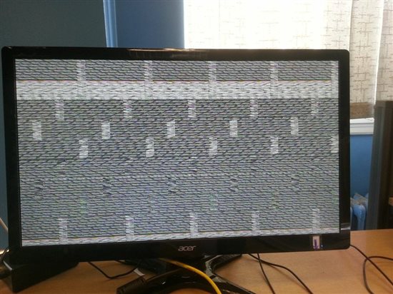

Hi there,
I'm interfacing a TVP5147M1 decoder, with a PAL camera source, to the DM8168EVM and using OpenMax Testbench to capture video frames. As there is no direct support for TVP5147, I have used a modified version of the capture_dei_encode.oms example for hardware debugging.
The output from the TVP5147 is 8-bit embedded sync 4:2:2 YCbCr, which is connected to VIP[0]B of the EVM
I have confirmed the wired connections are valid, but am only able to produce garbage output on my HDMI display, which looked like this, with the script in its original state, with only the hardware port settings changed:
And like this, now that I have tried changing resolution and buffer sizes in the script:
As this is my first time working with hardware of this type, video signals, and the OpenMax framework - I'd like to know if there are properties for the OMX components which I have set incorrectly; or even better, if anyone would be able to share a working capture chain (script or ilclient.c) for PAL/NTSC video.
Also including my OMTB script:
