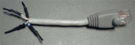

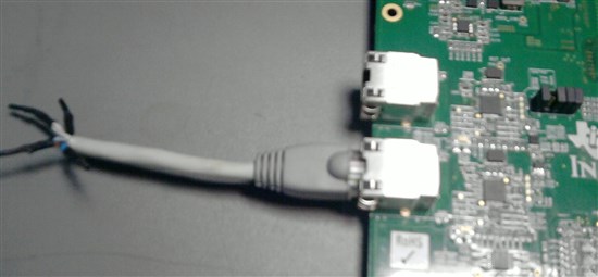

HI,
i am writing code to test Ethernet interface in u-boot with loopback method. i have taken the CCS code and made it compile in u-boot but the test id getting struct in waiting for link condition.
here i am attaching the code file.
