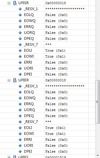

//config UPIES---uPP Interrupt Enabled Status Register (UPIER)
upp_config.UPIES.bits.EOLI= 0x01; //turn on EOL(end of line) interrupt for CHA(DMA channel I)
upp_config.UPIES.bits.EOWI= 0x01; //turn on EOW(end of window)interrupt for CHA(DMA channel I)
upp_config.UPIES.bits.EOLQ= 0x01; //turn on EOL(end of line) interrupt for CHB(DMA channel Q)add by wh 20140211
upp_config.UPIES.bits.EOWQ= 0x01; //turn on EOW(end of window)interrupt for CHB(DMA channel Q)add by wh 20140211

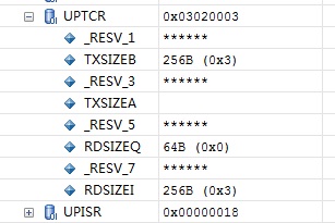

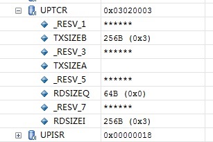

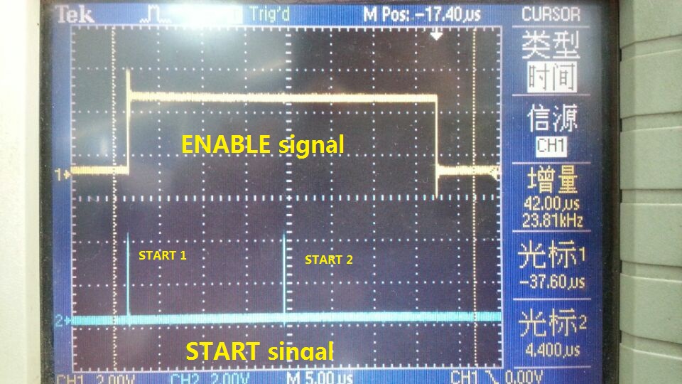

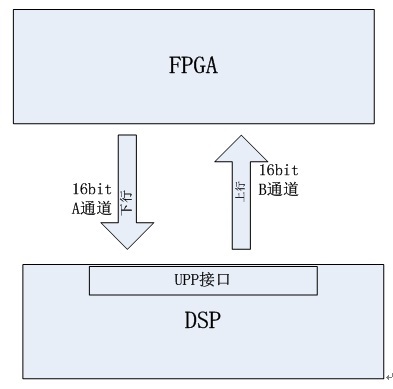

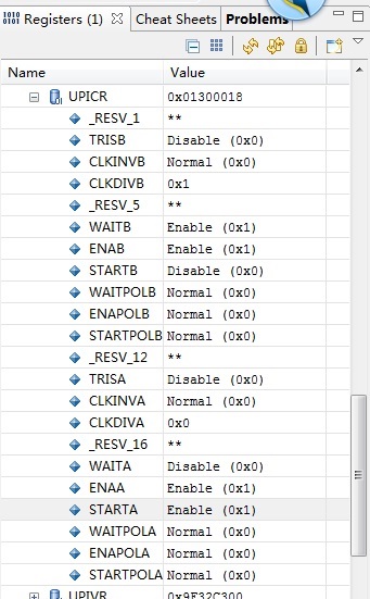

目前在调试TMS320VC6748 dsp,使用UPP口与FPGA接口,使用CHA从FPGA接收数据到DSP内计算,将计算结果通过UPP口的CHB通道发送 给FPGA;
遇到的问题:CHB发送时,在FPGA侧每个ENABLE信号为高期间,会有2个START信号,明显不符合时序,这是什么原因?
我自己分析可能与如下设置有关:
upp_config.UPTCR.bits.TXSIZEB = 3; //设置通道B的发送大小门槛为256Byte add by wh 20140211
//0h-64B,1h-128B,2h-reserved,3h-256B
是不是每次发送256Byte就会有一个START脉冲?通过调整发送窗口的总量,及TXSIZEB的设置值,好像没有什么规律,请各位大神
帮忙分析一下啊。

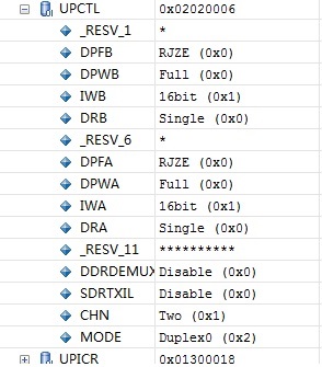

    From your uPP configuration,
    I presume that you are using "Duple mode 0"  ie CHA = Rx  & CHB = Tx
    Correct me if I'm wrong.
    upp_config.UPICR.bits.STARTA = 0x01;//使能CHA的START信号(接收模式)
    upp_config.UPICR.bits.ENAB = 0x01;//使能CHB的ENABLE信号(发送模式)add by wh 20140211
    upp_config.UPICR.bits.STARTB = 0x01;//使能CHB的START信号(发送模式)add by wh 20140211
    I'm suspecting the UPICR configuration, I think that you have configured & enabled the START signal for both the channels CHA as well CHB,
    Please refer the chapter 33.3.5 in TRM of OMAPL138
    STARTA
    0 - START signal is disabled. Channel A ignores START in receive mode.
    1 - START signal is enabled. Channel A honors START in receive mode.
    STARTB
    0 - START signal is disabled. Channel B ignores START in receive mode.
    1 - START signal is enabled. Channel B honors START in receive mode.
  • Dear
               Thanks a lot for your reply!
    I am using "Duple mode 0" mode,set CHA = Rx  & CHB = Tx;
     I have changed my UPICR configuration,but there is no change, 2 START signal  still  there.
    //upp_config.UPICR.bits.STARTA = 0x01;//使能CHA的START信号(接收模式)
    //upp_config.UPICR.bits.STARTB = 0x01;//使能CHB的START信号(发送模式)add by wh 20140211
    It is quitely strange.
        best  regard !

    interrupt void timer1_isr(void)//timer1 interrupt ISR
    		if(g_uppsendflag &&(g_int_count/2!=g_uppsendcnt))//upp�������
    //			for(upp_j=0;upp_j<1024;upp_j++)
    //				upp_data_send[0][upp_j]=upp_j+upp_up;// �ù�����
    //				upp_data_send[1][upp_j]=upp_j+upp_up+1024;// �ù�����
    //				upp_data_send[2][upp_j]=upp_j+upp_up+2048;// �ù�����
    //				upp_data_send[3][upp_j]=upp_j+upp_up+3072;// �ù�����
    //			upp_up +=4096;
    			UPP->UPQD0 = (uint32_t)&upp_data_send;
    			UPP->UPQD1 = 0x00010800;  //����1�����ݣ�256*4 words per line
    			UPP->UPQD2 = 0x00000800;
    			g_uppsendflag =0;
    //			g_int_count_old = g_int_count;
    			g_uppsendcnt++;
    	return;

    interrupt void upp_isr(void)
      UPISR_t interrupt_status;
      interrupt_status.value = UPP->UPIER;
      while (interrupt_status.value != 0)
        if (interrupt_status.bits.EOLI)
    		//interrupt_status.bits.EOLI = 1; // clear EOLI
    		UPP->UPIER |= (0x10);//clear EOLI bit in UPIER
        	if (interrupt_status.bits.EOWI)
    		    UPP->UPIER |= (0x08);
    		    UPP->UPID0 = (uint32_t)&upp_data_recv[0];//[0+g_count.m_UppIntCount*256];//add next DMA transfer
    			UPP->UPID1 = 0x00040800;  //1 lines 256*4 words per line 0x200--512byte
    			UPP->UPID2 = 0x00000800;
        	//interrupt times count
        	g_int_count++;//
    	if (interrupt_status.bits.DPEI)
    		//interrupt_status.bits.DPEI = 1; // clear DPEI
    		UPP->UPIER |=(0x01);//clear DPEI bit in UPIER
    		// Handle DPEI...
    	if(interrupt_status.bits.EOLQ)
    		UPP->UPIER |=(0x1000);//�� EOLQ bit in UPIER Ϊ1 ������������жϣ�
    	if(interrupt_status.bits.EOWQ)
    		UPP->UPIER |=(0x0800);//�� EOLQ bit in UPIER Ϊ1 ��������ʹ����жϣ�
    		if(!g_uppsendflag)
    			g_uppsendflag = 1;
    //		if(g_int_count&2)//upp�ж�2�Σ�����һ��
    //			upp_up +=4096;
    //			UPP->UPQD0 = (uint32_t)&upp_data_send;
    //			UPP->UPQD1 = 0x00040800;  //����1�����ݣ�256*4 words per line
    //			UPP->UPQD2 = 0x00000800;
    	if (interrupt_status.bits.DPEQ)
    		UPP->UPIER |=(0x0100);//�� DPEQ bit in UPIER Ϊ1 ���������DPEQ��
        // loop again if any interrupts are left
      } // end of while
      // write end of interrupt vector to allow future calls
      UPP->UPEOI = 0;
    // //close led
     } // end of function

    void upp_set(uint16_t * recv_addr) //upp port set
    	upp_config_t  upp_config;//init upp part use
    //upp reg set
    	//config UPDLB---uPP Digital Loopback Register(UPDLB) �����Ի��Ĵ�����B���ͣ�A����
    //	upp_config.UPDLB.bits.BA = 0x01;//ʹ��B��A���ͣ����ڲ���
    //	upp_config.UPDLB.bits.AB = 0;   //�ر�A��B���ͣ����ڲ���
    	//config UPCTL---uPP Channel Control Register (UPCTL)
    	upp_config.UPCTL.bits.IWA = 0x01;	//interface wide of CHA = 16�������
    	upp_config.UPCTL.bits.IWB = 0x01;	//interface wide of CHB = 16������� add by wh 20140211
    	upp_config.UPCTL.bits.DPWA = 0;     //����Aͨ������ģʽ
    	upp_config.UPCTL.bits.DPWB = 0;     //����Bͨ������ģʽ add by wh 20140211
    	upp_config.UPCTL.bits.CHN = 1;	    //ʹ��Aͨ����Bͨ���齨˫��ͨ�� add by wh 20140211
    	upp_config.UPCTL.bits.MODE = 2;	    //˫��ͨѶģʽ��Aͨ�����գ�Bͨ������ add by wh 20140211
    	upp_config.UPCTL.bits.DRA = 0;	//����Aͨ��Ϊ�������ݴ����ٶ�double data rate--add by wh 20140328 PMU �õ����ʷ�ʽ
    	upp_config.UPCTL.bits.DRB = 0;	//����Bͨ��Ϊ�������ݴ����ٶ�double data rate
    	upp_config.UPCTL.bits.SDRTXIL =0; //��������ʱ���ý���ģʽ add by wh 20140403
    	upp_config.UPCTL.bits.DDRDEMUX = 0; //˫������ʱ���ý���ģʽ add by wh 20140403	//Each peripheral channel is associated with its own DMA channel.
    	//config UPICR ---uPP Interface Configuration Register (UPICR)
    	upp_config.UPICR.bits.ENAA = 0x01;//ʹ��CHA��ENABLE�ź�(����ģʽ)
    //	upp_config.UPICR.bits.STARTA = 0x00;//ʹ��CHA��START�ź�(����ģʽ)
    	upp_config.UPICR.bits.ENAB = 0x01;//ʹ��CHB��ENABLE�ź�(����ģʽ)add by wh 20140211
    //	upp_config.UPICR.bits.STARTB = 0x00;//ʹ��CHB��START�ź�(����ģʽ)add by wh 20140211
    	upp_config.UPICR.bits.WAITB = 0x01;//ʹ��CHB��WAIT�ź�(����ģʽ)add by wh 20140211
    	upp_config.UPICR.bits.CLKDIVB =0x01;//CHB��clock 2��Ƶ  clockin/(2*(CLKDIVB+1))= 456/2/(2(1+1))=57 ˫������Ϊ114MHz  add by wh 20140211
    	//config UPIVR---uPP Interface Idle Value Register (UPIVR)  �����ÿ���ʱA,B�����ϵ�ȱʡֵ add by wh 20140211
    	//config UPTCR---uPP Threshold Configuration Register (UPTCR)
    	upp_config.UPTCR.bits.RDSIZEI = 3;//Read threshold for DMA Channel I. Controls burst size for DMA Channel I.
    	upp_config.UPTCR.bits.TXSIZEB = 3;   //����ͨ��B�ķ��ʹ�С�ż�Ϊ256Byte add by wh 20140211
    //	upp_config.UPTCR.bits.RDSIZEI =0;
    //	upp_config.UPTCR.bits.RDSIZEQ =0;
    	upp_config.UPPCR.bits.EN = 0x01;  //Set the EN bit in the uPP peripheral control register (UPPCR) to 1 to turn on the uPP peripheral.
    Do not comment the both the STARTx lines, Instead,
    upp_config.UPICR.bits.STARTA = 0x01;//使能CHA的START信号(接收模式) // Enable START signal since It is in Rx mode
    upp_config.UPICR.bits.STARTB = 0x0;//使能CHB的START信号(发送模式)add by wh 20140211 //// Disable START signal since It is in Rx
  • set as below:
    upp_config.UPICR.bits.STARTB = 0x00;//使能CHB的START信号(发送模式)add by wh 20140211
    There still have 2 START pulse!
    The example code is provied by the 3rd support from Arrow SEED (HK) Limited Co.(北京艾睿合众科技有限公司)
    4274.02.Test Demos under CCS.rar
    Ensure your configuration that you have modified from original,
    Is this affects the performance of uPP or even not able to initiate the transfer?
  • Dear
               The code mostly is wrote by myself,and I watch the registers,It is seemly right .
    I have some snap picture of registers setting.
     best rregards!
    "Is this affects the performance of uPP or even not able to initiate the transfer?"
    reply: This problem affects little,the code of FPGA now can work well,I just want to know the trues.
    Thanks anyway.
    Please refer the chapter 33.2.6.2 & 33.2.6.3 in TRM to tune the uPP,
