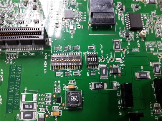

    One more thing, when I do the flashing, the switch should be all off? Or I should configured it to NAND boot like the link you posted? Previously, I configured it to NAND boot when I flash.
    Benz
  • Benz,
    Benz Kek said:
    I flash it using NETRA Nand provided in ti-ezsdk_dm814x-evm_5_05_02_00.
    Do you mean you are using the pre-built NAND flash writer, available at:
    ti-ezsdk_dm814x-evm_5_05_02_00/board-support/host-tools/nand-flash-writer.out
    If yes, this is correct.
    You need to follow the steps described in:
    http://processors.wiki.ti.com/index.php/DM814x_AM387x_PSP_Flashing_Tools_Guide#Burning_images_to_NAND_Flash_.28using_CCS.29
    Before connecting to CCS, make S1 switches BTMODE[4:0] = 00000, S1.8 = 1 (16-bit NAND selected), and SW2.1 = 1 (NAND enable).
    After you flash the u-boot.min.nand successfully, you need to configure S1 switches BTMODE[4:0] to boot from NAND.

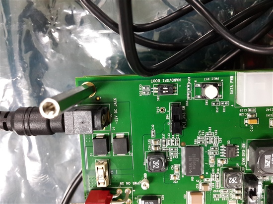

  • Pavel,
    The following images is my switch configuration.
    Now I in the middle of flashing, but the details doesn't seems correct.

    It keeps failing in erasing like what I faced during the beginning time when I do this on my own until I configure the switch to NAND boot but with S1.8 = 1 (16-bit NAND selected) as shown below.
    Benz
  • Benz,
    It seems that you have very old DM814x EVM PG1.x (where NAND is 8-bit), while I am having DM814x EVM PG2.x (where NAND is 16-bit).
    Next to the S1 switch, you have "DM814x/AM387x BASE EVM REV D", while I have "814x/387x BASE EVM DDR3 PG2.0 EVM REV C"
    So, can you try with S1 BTMODE[4:0] = 00000, S1.8 = 0 (NAND 8-bit)
    Also, you should invoke the GEL file scripts with its PG1.x option:
    http://processors.wiki.ti.com/index.php/DM814x_AM387x_PSP_Flashing_Tools_Guide#Loading_GEL_File
    PG1.x
    • Select Scripts --> Centaurus System Initialization --> PLL_CLOCKS_Config. This should setup all the clocks.
    • Now select Scripts --> Centaurus System Initialization --> DDR2_Initialization. This should setup EMIF for DDR2.
    • And then select Scripts --> Centaurus System Initialization --> GPMC_ClkEnable. This should initialize GPMC.
    Let me know the result.

  • Benz,
    I have NAND with 16-bit bus, thus my S1.8 is set to 1. Thus when I load the u-boot from SD I have:
    picocom v1.4

    Can you do the same at your side and post the console output here? I mean first boot from MMC/SD card with S1.8=1 (NAND 16-bit) then with S1.8=0 (NAND 8-bit).
    Pavel

    Both was executed with SW2.1 set to 1.
    Benz

  • Just to be sure we refer to the same thing, the S1.8 switch I refer is from the switch below:
    Pavel
  • Pavel,
    Ya, the switch shown in the photo. We change the number 8, right?
    Benz
    Right.
    Also, in this picture, number 1 to 5 correspond to BTMODE[0:4] and are configured for MMC/SD boot in this picture.
    So, when you flash the NAND, S1.[1:5] (BTMODE[0:4]) should be all OFF (0).
    When booting from MMC/SD card, S1.[1:5] = 11101 (BTMODE[4:0] = 10111)
    When booting from NAND, S1.[1:5] = 01001  (BTMODE[4:0] = 10010)
    Pavel
