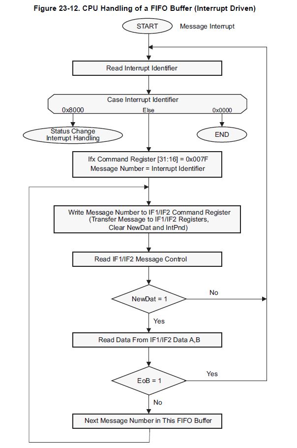

The section "23.3.15.12 Reading From a FIFO Buffer" says:
Reading from a FIFO buffer message object and resetting its NewDat bit is handled the same way as
reading from a single message object.
and the flowchart Fig 23-12 show that the operation is sequential: read 1 message, clear NewDat, ..etc and then start again on the next message.
Q: Is it a requirement to do it sequentialy? Or can it be paralelized like read n messages, clear n Newdat bits, ..etc?
In the current Linux driver above it seems to have paralelized the access to the FIFO buffer. This look to work most of the time but still dropping some messages from time to time (see problem description).

We have instrumented the bug fixed driver and found the following issue.
The driver uses 16 buffers as RX FIFO to avoid potential reordering issues. The logic of the receive routine is to read the first 8 packets from message buffer 1-8 but it leaves the NewDat bits on,
so the hardware message handler will queue the packets at the end.
After reading message buffer 8, it clears the newdat bits of message buffer 1-8, so the hardware message handler starts queuing from the beginning of the FIFO again.
That works most of the time, but we can connect the packet loss to that way of handling the message buffer.
RX Packet 1 --> message buffer 1 (newdat bit is not cleared) RX Packet 2 --> message buffer 2 (newdat bit is not cleared) RX Packet 3 --> message buffer 3 (newdat bit is not cleared)
RX Packet 4 --> message buffer 4 (newdat bit is not cleared) RX Packet 5 --> message buffer 5 (newdat bit is not cleared) RX Packet 6 --> message buffer 6 (newdat bit is not cleared)
RX Packet 7 --> message buffer 7 (newdat bit is not cleared) RX Packet 8 --> message buffer 8 (newdat bit is not cleared)
Clear newdat bit in message buffer 1
Clear newdat bit in message buffer 2
Clear newdat bit in message buffer 3
Clear newdat bit in message buffer 4
Clear newdat bit in message buffer 5
Clear newdat bit in message buffer 6
Clear newdat bit in message buffer 7
Clear newdat bit in message buffer 8
Now if during that clearing of newdat bits, a new message comes in, the HW gets confused and drops it.
It doesn’t matter how many of them you clear. I put a delay between clear of buffer 1 and buffer 2 which was long enough that the message should have been queued either in buffer 1 or buffer 9.
But it did not show up anywhere. The next packet after the dropped one ended up in buffer 1. So the hardware lost a packet of course without telling it via one of the error mechanisms.
That does not happen on all clear newdat bit events, but the instrumentation clearly proves that the packet loss is always during the clearing of the newdat bits of the lower message buffers.
