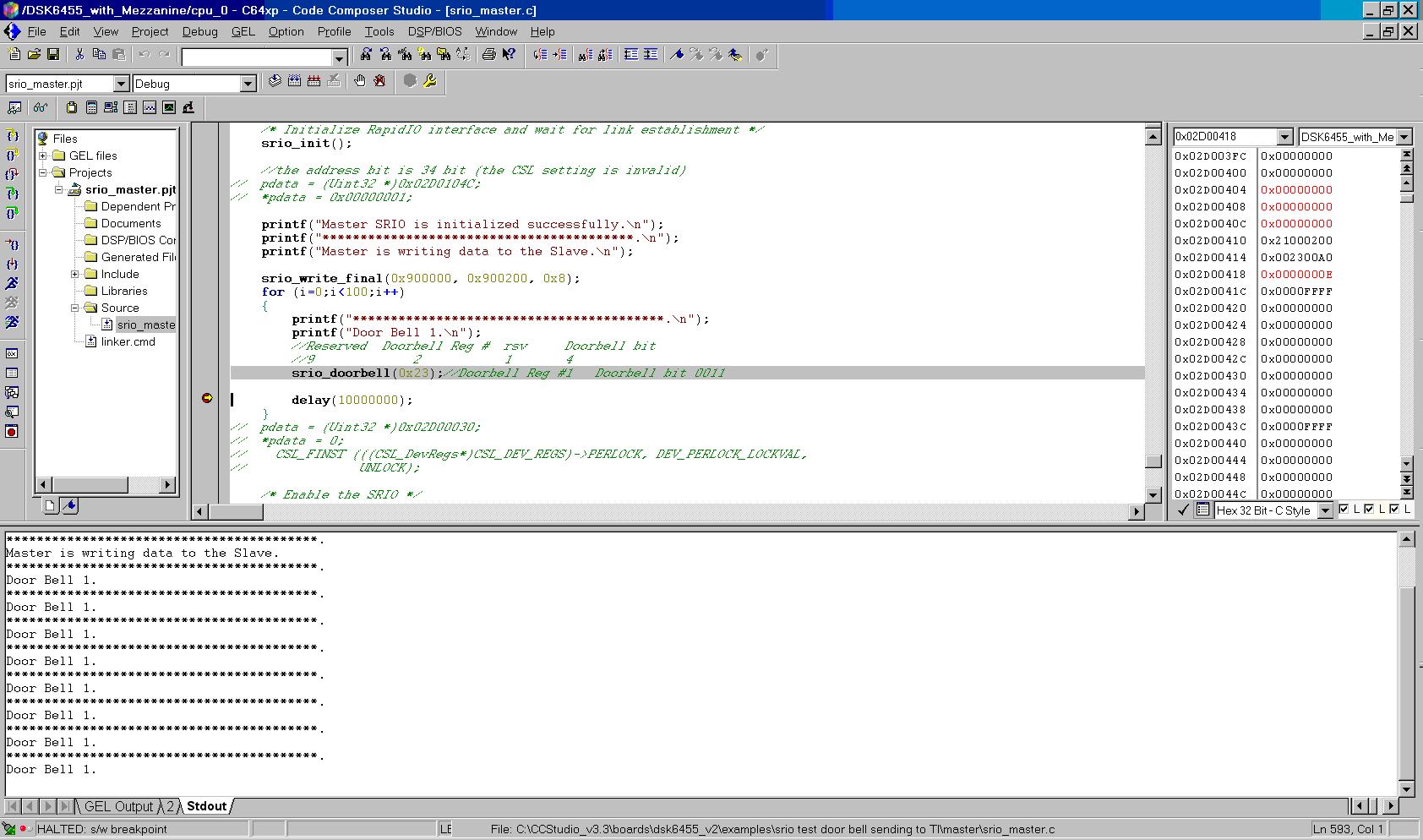

I am using C6455 EVM to do SRIO doorbell testing. In the Master board, I have the following code, which send 100 doorbells to Slave board (Mezzanine). However, on the slave side, I can only receive 6 door bells. Also, the print out on the slave part is very slow and shows different pace as the master board sends out the doorbell. I am wondering what caused this problem. Thank you very much,
Master code
srio_init();
for (i=0;i<100;i++)
    printf("*****************************************.\n");
    printf("Door Bell 1.\n");
    //Reserved  Doorbell Reg #  rsv  Doorbell bit
    //9  2  1   4
    srio_doorbell(0x23);//Doorbell Reg #1   Doorbell bit 0011
    delay(10000000);

The output window on slave board is as following
0 Doorbell received. 8
1 Doorbell received. 8
2 Doorbell received. 8
3 Doorbell received. 8
4 Doorbell received. 8
5 Doorbell received. 8

  • Update of the methods based on your recommendations
    Method 1 space out your doorbell transactions on the master side with a timer
    It did not work, even though I slow down my doorbell transaction with a huge delay.
    Method 2 use more of the doorbell interrupt ICSR bits
    It did not work either. The symptom is the same as before and the slave stopped getting further doorbell after 6 iterations
    There is a very interesting result. If I assign Doorbell bit as 1 on the master side, in a successful case, the slave part will be with a resp_db.data as 2.  Should these two be the same?

    In my original code, after I run the master 8 times, the CC is with a value 111 (Transaction complete, Packet not sent due to unavailable outbound credit at given priority). I do not know how this happened.  In the first 7 iteration, I can see in the CC(02D00418 RIO_LSU1_REG6), the value is alway 000 (Transaction complete, No Errors (Posted/Non-posted))

    Actually, here is what happend in the LSU1_REGn (n is from 0 to 6) before and after the CCC 111 was present in the REG6 and it is just FYI.
    RIO_LSU1_REG0 0x00000000
    RIO_LSU1_REG1 0x00900208
    RIO_LSU1_REG2 0x00900008
    RIO_LSU1_REG3 0x00000000
    RIO_LSU1_REG4 0x20000200
    RIO_LSU1_REG5 0x00000054
    RIO_LSU1_REG6 0x00000000
    RIO_LSU1_REG1 0x00000000
    RIO_LSU1_REG2 0x00000000
    RIO_LSU1_REG4 0x21000200
    RIO_LSU1_REG5 0x002300A0
    RIO_LSU1_REG6 0x0000000E
