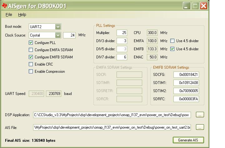

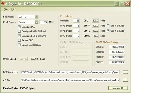

  • Ringo,
    I still can't get mine to work.  Can you verify that we are using the same applications:
    AISgen for D800K001 version: 0.9.0.0
    UART Boot Host version: v1.0
    Here is a screenshot of generating the AIS binary:
    Here is a dump of output from UART Boot Host:
    (File IO): Read 136940 bytes from file C:\CCStudio_v3.3\MyProjects\dsp\development_projects\omap_l137_evm\power_on_test\Debug\power_on_test_uart2.bin.
    (Serial Port): Opening COM3 at 230400 baud...
    (AIS Parse): Read magic word 0x41504954.
    (AIS Parse): Waiting for BOOTME...
    (AIS Parse): Performing Start-Word Sync...
    (AIS Parse): Performing Ping Opcode Sync...
    (AIS Parse): Processing command 0: 0x5853590D.
    (AIS Parse): Performing Opcode Sync...
    (AIS Parse): Executing function...
    (AIS Parse): Processing command 1: 0x5853590D.
    (AIS Parse): Processing command 2: 0x58535907.
    (AIS Parse): Loading boot table...
    (AIS Parse): Processing command 3: 0x58535904.
    (AIS Parse): CRC disabled.
    (AIS Parse): Processing command 4: 0x58535901.
    (AIS Parse): Loading section...
    (AIS Parse): Loaded 512-byte section to address 0x1182DC00.
    (AIS Parse): Processing command 5: 0x58535901.
    (AIS Parse): Loaded 22944-byte section to address 0x1181E620.
    (AIS Parse): Processing command 6: 0x58535901.
    (Serial Port): Read error! (The operation has timed out.)
    (AIS Parse): I/O Error in read!
    (System): Boot aborted by user.
    (Serial Port): Closing COM3.
    ----> I always get a unrecoverable Read error at "Processing command 6".  Have you ever gotten this?

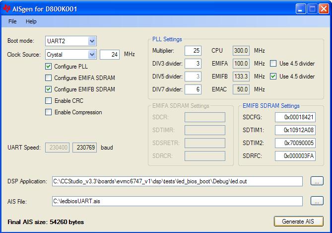

  • Hi Mike,
    I was able to make it work. I attached the ais file. Also, here is the GenAIS screen:
    With the correct file I get:
    (File IO): Read 54260 bytes from file C:\ledbiosUART.ais.

    If I generate a ais file for spi flash and try to run with UART boot I get the error:
    (AIS Parse): Processing command 0: 0x58535963.
    (AIS Parse): No slave memory present; Sequential Read Enable has no effect.
    (AIS Parse): Processing command 2: 0x5853590D.

  • Hi Mariana,
    Thanks for helping with this.  I downloaded your ais file and tried it on my EVM.  It did NOT work.  It choked at the same place my program did "processing command 6".
    If it was built for SPI insteadof UART2 it would have failed at "processing command 2".  So any ideas what the problem could be?  Should I try it with another PC?
    Here is what we can verify:
    1. It is correctly built for UART2 (both your program and mine)
    2. both programs fail at "processing command 6" - What does that mean?
    3. I am correctly connected to UART2.  I tested this with a terminal window and do see the "BOOTME" prompt.  Also we would not get past the "wait for BOOTME indication if we were not properly connected to UART2.
    Any other ideas?
    Mike

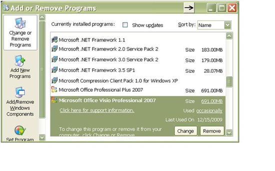

  • Mike,
    It's interesting that the UART Host utility works for you with one PC but not another.  Would you be willing to share some more information about your two PCs?  Specifically, I would be curious to know the following:
    • Installed version of .NET framework (or Mono)
    • Serial port used (manufacturer, model no., driver version, etc.)
    Also, please let us know if you are able to correct the issue by adjusting your driver settings.
    Regarding your question on input clocks, technically it is possible to use UART boot with a different input clock.  The problem, as you are aware, is that the UART peripheral uses fixed divisors during boot, and you will end up operating at a non-standard baud rate.  For 19.2 MHz, you will have to operate at ~184.3 kbps, which may be difficult or impossible without low-level control of the external UART device.  Most PC serial port drivers, for instance, will not allow you to operate at a non-standard baud rate.  (You will probably be able to select 115.2 kbps or 230.4 kbps with no in-between values.  Neither speed will be able to communicate with a device operating at 184.3 kbps.)
    I realize that your input clock speed is probably non-negotiable, but some other clock values may give you a usable UART baud.  For instance, a 12 MHz input clock would cause UART boot to run at 115.2 kbps.
    Hope this helps.

  • Hi Joe,
    Thanks for the input.  Here are answers to your questions:
    On both PCs, I used the same serial cable (e.g. the one that shipped with the L-137 EVM), plus a USB to serial bridge.  This shows up as a "ATEN USB to Serial Bridge (COM3)" in the Windows Device Driver folder.  The device itself lists the model # as GUC232A.  But since I'm using the exact same cables on both machines, I doubt this is the culprit.  I'm on the laptop now and here is the installed .NET apps:
    I'll have to check my other PC later this week to do a comparison.

  • Dear Mariana,
    thank you for your file (ledbiosUART.ais ).
    my target have D800K001 but I used AISgen for D800K003 . I added some configuration functions ( void Setup_Psc_All_On( ) and void Setup_System_Config( ) )in the main page of my project for configuration of the hardware. in AISgen for D800K003 window , i set boot mode on SPI0 flash, then selected file --->configure for EVM  and then Generat AIS . but it didn't work .
    I tried  by setting boot mode on UART2 .it didn't work,too.
    I used your file (ledbiosUART.ais) and it worked on my target .
    is the problem about AISgen for D800K003or about my source code ? would you please send me your project and c codes?
    Zahra Mazaheri.
  • Attached is the project I used for the Led with bios.
    Please also see:
    http://processors.wiki.ti.com/index.php/Flashing_the_C6747_EVM
    led_bios_boot.zip
  • Dear Mariana,
    thank you a lot for your helps .
      I unchecked  PINMUX & LPSC settings check boxes in AISgen for D800K003 window before making AIS image. and my application worked correctly .
