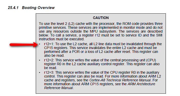

    Also, if anybody cares, the  piece of information I was missing in my L2 cache enable is
        mov r12, #0x1   ;;set up to invalidate L2
        DCD 0xE1600070    ;;Call SMI monitor
    I now have L2 cache working perfectly.
    Thanks for sharing.  I think instead of the magic number you can just put in the instruction "SMI" (or maybe it was (SMI #0).  That's mentioned in the "Initialization" chapter of the TRM.  Here's a screenshot.
    I've had some other customers that had issues with the L2 cache.  What we discovered in the end was that the SMI call to enable the L2 cache should only be done ONCE during initialization.  Any subsequent operations should use the usual MCR/MRC instructions, otherwise you will get an unintended reset.

    PS.  I tracked down the proper mnemonic -- though now I forget if this was using the ARM compiler or GCC!  (Maybe it doesn't matter...)
        SMCEQ #0    ;;Call SMI monitor
    The SMCEQ #0 instruction disassembles to 0xE1600070 like you have above but looks a lot less cryptic!
  • SMC = Secure Monitor Call. Does work with the ARM Realview compiler. The instruction used to be SMI. Very odd that I needed an instruction from ARM Architecture Reference Manual Security Extensions Supplement. Anyway, it does work, and I beleive you are correct about only using it once and from then on using the usual methods to clean and invalidate cache.
