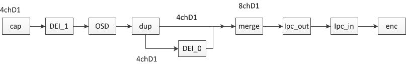

Hi, we use DM8168, TVP5158, RDK4.0.
The data flow is:
There has a strange problem.
The setting of DEI_0 and DEI_1 is same just the ID is not, one is SYSTEM_LINK_ID_DEI_HQ_0 and the other is SYSTEM_LINK_ID_DEI_HQ_1.
I set the channel number for DEI_0 is 0, 1, 2, 3, and the another dup output is 4,5,6,7, just channel 0 duplicate to channel4.
I static the procced frames in VcapVenc_bitsWriteMain() for every 30s.
If the input for channel 0 is PAL, the encoded frames are only 625, but the channel 4 is 750.
If the input for channel 0 is NTSL, the encoded frames are 750, but the channel 4 is 900.
What's the problem?

     [m3video] [links_m3video/iva_enc/encLink_common.c:2031]   7 |      59       0       29  29 255 / 68515
     [m3video]
     [m3video] Multi Channel Encode Average Submit Batch Size
     [m3video] Max Submit Batch Size : 24
     [m3video] IVAHD_0 Average Batch Size : 1
     [m3video] IVAHD_0 Max achieved Batch Size : 3
     [m3video] IVAHD_1 Average Batch Size : 1
     [m3video] IVAHD_1 Max achieved Batch Size : 2
     [m3video] IVAHD_2 Average Batch Size : 0
     [m3video] IVAHD_2 Max achieved Batch Size : 0
     [m3video]
     [m3video] Multi Channel Encode Batch break Stats
     [m3video] Total Number of Batches created: 7777
     [m3video] All numbers are based off total number of Batches created
     [m3video]       Batch breaks due to batch sizeexceeding limit: 0 %
     [m3video]       Batch breaks due to ReqObj Que being empty: 100 %
     [m3video]       Batch breaks due to changed resolution class: 0 %
     [m3video]       Batch breaks due to interlace and progressivecontent mix: 0 %
     [m3video]       Batch breaks due to channel repeat: 0 %
     [m3video]       Batch breaks due to different codec: 0 %
     [m3video] Total Number of Batches created: 7647
     [m3video] Total Number of Batches created: 0
     [m3video]       Batch breaks due to ReqObj Que being empty: 0 %
     [m3vpss ]
     [m3vpss ]  169943: LOAD: CPU: 11.8% HWI: 1.4%, SWI:1.3%
     [m3vpss ]
     [m3vpss ]  169944: LOAD: TSK: IPC_OUT_M30         : 1.4%
     [m3vpss ]  169944: LOAD: TSK: IPC_FRAMES_OUT0     : 1.1%
     [m3vpss ]  169944: LOAD: TSK: CAPTURE             : 0.4%
     [m3vpss ]  169944: LOAD: TSK: DEI0                : 1.6%
     [m3vpss ]  169944: LOAD: TSK: DEI1                : 2.2%
     [m3vpss ]  169944: LOAD: TSK: DUP0                : 0.4%
     [m3vpss ]  169944: LOAD: TSK: MERGE0              : 0.3%
     [m3vpss ]  169944: LOAD: TSK: MISC                : 1.7%
     [m3vpss ]
     [m3video]
     [m3video]  170445: LOAD: CPU: 9.6% HWI: 0.6%, SWI:0.9%
     [m3video]
     [m3video]  170445: LOAD: TSK: IPC_IN_M30          : 0.4%
     [m3video]  170445: LOAD: TSK: IPC_BITS_OUT0       : 1.0%
     [m3video]  170445: LOAD: TSK: ENC0                : 2.0%
     [m3video]  170446: LOAD: TSK: ENC_PROCESS_TSK_0   : 2.1%
     [m3video]  170446: LOAD: TSK: ENC_PROCESS_TSK_1   : 2.1%
     [m3video]  170446: LOAD: TSK: MISC                : 0.5%
     [m3video]
     [c6xdsp ]
     [c6xdsp ]  169395: LOAD: CPU: 0.7% HWI: 0.0%, SWI:0.0%
     [c6xdsp ]
     [c6xdsp ]  169395: LOAD: TSK: IPC_FRAMES_IN0      : 0.2%
     [c6xdsp ]  169395: LOAD: TSK: ALG0                : 0.2%
     [c6xdsp ]  169395: LOAD: TSK: MISC                : 0.3%
     [c6xdsp ]
     [m3vpss ]
     [m3vpss ]  *** Capture Driver Advanced Statistics ***
     [m3vpss ]
     [m3vpss ]  VIP Parser Reset Count : 0
     [m3vpss ]
     [m3vpss ]      |   Total    Even     Odd  Total  Even   Odd  Min /  Max  Min /  Max Dropped Fid Repeat Frame Error Y/C
     [m3vpss ]  CH  |  Fields  Fields  Fields    FPS   FPS   FPS       Width      Height  Fields      Count (Desc Error Y/C)
     [m3vpss ]  ------------------------------------------------------------------------------------------------------------
     [m3vpss ]  000 |    5295    2648    2647     50    25    25  720 /  720  288 /  288       1          1 0/0 (0/0)
     [m3vpss ]  001 |    6322    3161    3161     60    30    30  720 /  720  243 /  244       1          0 0/0 (0/0)
     [m3vpss ]  002 |    6322    3161    3161     60    30    30  720 /  720  243 /  244       1          0 0/0 (0/0)
     [m3vpss ]  003 |    6322    3161    3161     60    30    30  720 /  720  243 /  244       1          0 0/0 (0/0)
     [m3vpss ]
     [m3vpss ]  VIP Capture Port 0 | DescMissMatch1 = 0, DescMissMatch2 = 0 , DescMissMatch3 = 0
     [m3vpss ]
     [m3vpss ]  *** Capture List Manager Advanced Statistics ***
     [m3vpss ]
     [m3vpss ]  List Post Count        : 13242
     [m3vpss ]  List Stall Count       : 0
     [m3vpss ]  List Post Time (ms)    : Max = 0, Min = 0, Avg = 0, Total = 0
     [m3vpss ]  INTC Timeout Count     : (0, 0) (Min timeout value = 984, 1000)
     [m3vpss ]  Descriptor miss found count : 0
     [m3vpss ]
     [m3vpss ]
     [m3vpss ]  VIP and VPDMA registers,
     [m3vpss ]  VIP0 : FIQ_STATUS  : 0x4810551c = 0x00000000
     [m3vpss ]  VIP1 : FIQ_STATUS  : 0x48105a1c = 0x00000000
     [m3vpss ]  VPDMA: LIST_BUSY   : 0x4810d00c = 0x00100000
     [m3vpss ]
     [m3vpss ]
     [m3vpss ] [links_m3vpss/capture/captureLink_drv.c:2465] 182922: CAPTURE: Fields = 24257 (fps = 229, CPU Load = 0)
     [m3vpss ] [links_m3vpss/capture/captureLink_drv.c:2470] 182922: CAPTURE: Num Resets = 0 (Avg 0 ms per reset)
     [m3vpss ]  182922: SYSTEM  : FREE SPACE : System Heap      = 67920 B, Mbx = 10239 msgs)
     [m3vpss ]  182922: SYSTEM  : FREE SPACE : SR0 Heap         = 16839552 B (16 MB)
     [m3vpss ]  182923: SYSTEM  : FREE SPACE : Frame Buffer     = 592092032 B (564 MB)
     [m3vpss ]  182923: SYSTEM  : FREE SPACE : Bitstream Buffer = 281550720 B (268 MB)
     [m3vpss ]
     [m3vpss ]
     [m3vpss ] TILER_STATS: CNT :8BIT
     [m3vpss ]
     [m3vpss ] TILER_STATS: CNT RESOLUTION:    16384 x 8192
     [m3vpss ]
     [m3vpss ] TILER_STATS: BUCKET RESOLUTION: 16384 x 8188
     [m3vpss ]
     [m3vpss ] TILER_STATS: NUM FREE BUCKETS:  1
     [m3vpss ]
     [m3vpss ] TILER_STATS: NUM USED BUCKETS:  0
     [m3vpss ]
     [m3vpss ] TILER_STATS: TOTAL FREE AREA:   134152192 (99 %)
     [m3vpss ]
     [m3vpss ] TILER_STATS: TOTAL USED AREA:   0 (0 %)
     [m3vpss ]
     [m3vpss ]
     [m3vpss ]
     [m3vpss ] TILER_STATS: CNT :16BIT
     [m3vpss ]
     [m3vpss ] TILER_STATS: CNT RESOLUTION:    32768 x 4096
     [m3vpss ]
     [m3vpss ] TILER_STATS: BUCKET RESOLUTION: 32768 x 4096
     [m3vpss ]
     [m3vpss ]
     [m3vpss ]
     [m3vpss ] TILER_STATS: TOTAL FREE AREA:   134217728 (100 %)
     [m3vpss ]
     [m3vpss ]
     [m3vpss ]  182924: SYSTEM  : FREE SPACE : Tiler 8-bit      = 134152192 B (127 MB)  - TILER ON
     [m3vpss ]  182925: SYSTEM  : FREE SPACE : Tiler 16-bit     = 134217728 B (128 MB)  - TILER ON
     [m3vpss ] [links_m3vpss/dei/deiLink_drv.c:2730]
     [m3vpss ] [links_m3vpss/dei/deiLink_drv.c:2731] *** [
     [m3vpss ] [links_m3vpss/dei/deiLink_drv.c:2732]
     [m3vpss ] [links_m3vpss/dei/deiLink_drv.c:2733] Elasped Time           : 0 secs
     [m3vpss ] [links_m3vpss/dei/deiLink_drv.c:2734] Total Fields Processed : 0
     [m3vpss ] [links_m3vpss/dei/deiLink_drv.c:2735] Total Fields FPS       : 0 FPS
     [m3vpss ] [links_m3vpss/dei/deiLink_drv.c:2736]
     [m3vpss ] [links_m3vpss/dei/deiLink_drv.c:2737]
     [m3vpss ] [links_m3vpss/dei/deiLink_drv.c:2738] CH  | In Recv In Reject In Process Out[0] Out[1] Out[2] Out[3] Out[4] Skip Out[0] Skip Out[1] Skip Out[2] Skip Out[3] Skip Out[4] User Out[0] User Out[1] User Out[2] User Out[3] User Out[4] Latency
     [m3vpss ] [links_m3vpss/dei/deiLink_drv.c:2739] Num | FPS     FPS       FPS        FPS    FPS    FPS    FPS    FPS       FPS         FPS         FPS         FPS         FPS       Skip FPS    Skip FPS    Skip FPS    Skip FPS    Skip FPS   Min / Max
     [m3vpss ] [links_m3vpss/dei/deiLink_drv.c:2740] -------------------------------------------------------------------------------------------------------------------------------------------------------------------------------------------------------
     [m3vpss ] [links_m3vpss/dei/deiLink_drv.c:2751]   0 |      52         0         52      0     52      0      0      0          52           0           0           0           0           0           0           0           0           0  14 /  37
     [m3vpss ] [links_m3vpss/dei/deiLink_drv.c:2751]   1 |      62         0         62      0     62      0      0      0          62           0           0           0           0           0           0           0           0           0  16 /  38
     [m3vpss ] [links_m3vpss/dei/deiLink_drv.c:2751]   2 |      62         0         62      0     62      0      0      0          62           0           0           0           0           0           0           0           0           0  19 /  38
     [m3vpss ] [links_m3vpss/dei/deiLink_drv.c:2751]   3 |      62         0         62      0     62      0      0      0          62           0           0           0           0           0           0           0           0           0  19 /  38
     [m3vpss ]
     [m3vpss ] [links_m3vpss/dei/deiLink_drv.c:2731] *** [] DEI Statistics ***
     [m3vpss ] [links_m3vpss/dei/deiLink_drv.c:2733] Elasped Time           : 865703252 secs
     [m3vpss ] [links_m3vpss/dei/deiLink_drv.c:2734] Total Fields Processed : 865703252
     [m3vpss ] [links_m3vpss/dei/deiLink_drv.c:2735] Total Fields FPS       : 865703252 FPS
     [m3vpss ] [links_m3vpss/dei/deiLink_drv.c:2751]   0 |      52         0         52      0     52      0      0      0          52           0           0           0           0           0           0           0           0           0  12 /  30
     [m3vpss ] [links_m3vpss/dei/deiLink_drv.c:2751]   1 |      62         0         62      0     62      0      0      0          62           0           0           0           0           0           0           0           0           0  14 /  31
     [m3vpss ] [links_m3vpss/dei/deiLink_drv.c:2751]   2 |      62         0         62      0     62      0      0      0          62           0           0           0           0           0           0           0           0           0  14 /  31
     [m3vpss ] [links_m3vpss/dei/deiLink_drv.c:2751]   3 |      62         0         62      0     62      0      0      0          62           0           0           0           0           0           0           0           0           0  14 /  31
     [m3vpss ]
     [m3vpss ]
     [m3vpss ]  *** IpcFramesOutRTOS Statistics ***
     [m3vpss ]
     [m3vpss ]  Elasped Time           : 21 secs
     [m3vpss ]  Total Fields Processed : 5042
     [m3vpss ]  Total Fields FPS       : 240 FPS
     [m3vpss ]
     [m3vpss ]
     [m3vpss ]  CH  | In Recv In Process In Skip
     [m3vpss ]  Num | FPS     FPS        FPS
     [m3vpss ]    0 |      52         52       0
     [m3vpss ]    1 |      62         62       0
     [m3vpss ]    2 |      62         62       0
     [m3vpss ]    3 |      62         62       0
     [m3vpss ]
     [c6xdsp ]
     [c6xdsp ]  *** SCD Statistics ***
     [c6xdsp ]
     [c6xdsp ]  Elasped Time           : 22 secs
     [c6xdsp ]  Total Fields Processed : 0
     [c6xdsp ]  Total Fields FPS       : 0 FPS
     [c6xdsp ]
     [c6xdsp ]
     [c6xdsp ]  CH  | In Recv In Process User Skip Process Skip In Process Time
     [c6xdsp ]  Num | FPS     FPS        FPS       FPS          per frame (msec)
     [c6xdsp ]  ----------------------------------------------------------------
     [c6xdsp ]
     [m3video]
     [m3video]      188938: HDVICP-ID:0
     [m3video] All percentage figures are based off totalElapsedTime
     [m3video]
     [m3video]               totalAcquire2wait :0 %
     [m3video]               totalWait2Isr :16 %
     [m3video]               totalIsr2Done :0 %
     [m3video]               totalWait2Done :16 %
     [m3video]               totalDone2Release :0 %
     [m3video]               totalAcquire2Release :16 %
     [m3video]               totalAcq2acqDelay :83 %
     [m3video]               totalElapsedTime in msec :  111891
     [m3video]               numAccessCnt:   11220
     [m3video]
     [m3video]              IVA-FPS :     101
     [m3video]
     [m3video]              Average time spent per frame in microsec:    1595
     [m3video]
     [m3video]      188939: HDVICP-ID:1
     [m3video]
     [m3video]               totalWait2Isr :19 %
     [m3video]               totalWait2Done :19 %
     [m3video]               totalAcquire2Release :19 %
     [m3video]               totalAcq2acqDelay :80 %
     [m3video]               totalElapsedTime in msec :  111873
     [m3video]               numAccessCnt:   12203
     [m3video]
     [m3video]              IVA-FPS :     109
     [m3video]
     [m3video]              Average time spent per frame in microsec:    1741
     [m3video]
     [m3video]      188939: HDVICP-ID:2
     [m3video]
     [m3video]               totalWait2Isr :0 %
     [m3video]               totalWait2Done :0 %
     [m3video]               totalAcquire2Release :0 %
     [m3video]               totalAcq2acqDelay :0 %
     [m3video]               totalElapsedTime in msec :       0
     [m3video]               numAccessCnt:       0
     [m3video]
     [m3video]              IVA-FPS :       0
     [m3video]
     [m3video]              Average time spent per frame in microsec:       0
     [m3video] [links_m3video/iva_enc/encLink_common.c:2015]
     [m3video] [links_m3video/iva_enc/encLink_common.c:2016] *** ENCODE Statistics ***
     [m3video] [links_m3video/iva_enc/encLink_common.c:2017]
     [m3video] [links_m3video/iva_enc/encLink_common.c:2018] Elasped Time           : 48096 secs
     [m3video] [links_m3video/iva_enc/encLink_common.c:2019]
     [m3video] [links_m3video/iva_enc/encLink_common.c:2020]
     [m3video] [links_m3video/iva_enc/encLink_common.c:2021] CH  | In Recv In Skip In User  Out Latency
     [m3video] [links_m3video/iva_enc/encLink_common.c:2022] Num | FPS     FPS     Skip FPS FPS Min / Max
     [m3video] [links_m3video/iva_enc/encLink_common.c:2023] --------------------------------------------
     [m3video] [links_m3video/iva_enc/encLink_common.c:2031]   0 |      52       0       30  21 255 / 68526
     [m3video] [links_m3video/iva_enc/encLink_common.c:2031]   1 |      62       0       36  26 255 / 68527
     [m3video] [links_m3video/iva_enc/encLink_common.c:2031]   2 |      62       0       36  26 255 / 68531
     [m3video] [links_m3video/iva_enc/encLink_common.c:2031]   3 |      62       0       36  26 255 / 68527
     [m3video] [links_m3video/iva_enc/encLink_common.c:2031]   4 |      52       0       26  26 255 / 68513
     [m3video] [links_m3video/iva_enc/encLink_common.c:2031]   5 |      62       0       31  31 255 / 68515
     [m3video] [links_m3video/iva_enc/encLink_common.c:2031]   6 |      62       0       31  31 255 / 68515
     [m3video] [links_m3video/iva_enc/encLink_common.c:2031]   7 |      62       0       31  31 255 / 68515
     [m3video]
     [m3video]
     [m3video] Total Number of Batches created: 1935
     [m3video] Total Number of Batches created: 1886
     [m3vpss ]
     [m3vpss ]  191945: LOAD: CPU: 11.7% HWI: 1.4%, SWI:1.3%
     [m3vpss ]
     [m3vpss ]  191945: LOAD: TSK: IPC_OUT_M30         : 1.4%
     [m3vpss ]  191945: LOAD: TSK: IPC_FRAMES_OUT0     : 1.1%
     [m3vpss ]  191945: LOAD: TSK: CAPTURE             : 0.4%
     [m3vpss ]  191946: LOAD: TSK: DEI0                : 1.5%
     [m3vpss ]  191946: LOAD: TSK: DEI1                : 2.0%
     [m3vpss ]  191946: LOAD: TSK: DUP0                : 0.4%
     [m3vpss ]  191946: LOAD: TSK: MERGE0              : 0.3%
     [m3vpss ]  191946: LOAD: TSK: MISC                : 1.9%
     [m3vpss ]
     [m3video]
     [m3video]  192447: LOAD: CPU: 9.5% HWI: 0.6%, SWI:0.9%
     [m3video]
     [m3video]  192447: LOAD: TSK: IPC_IN_M30          : 0.4%
     [m3video]  192447: LOAD: TSK: IPC_BITS_OUT0       : 1.0%
     [m3video]  192447: LOAD: TSK: ENC0                : 1.9%
     [m3video]  192447: LOAD: TSK: ENC_PROCESS_TSK_0   : 2.1%
     [m3video]  192447: LOAD: TSK: ENC_PROCESS_TSK_1   : 2.1%
     [m3video]  192447: LOAD: TSK: MISC                : 0.5%
     [m3video]
     [c6xdsp ]
     [c6xdsp ]  191397: LOAD: CPU: 0.6% HWI: 0.0%, SWI:0.0%
     [c6xdsp ]
     [c6xdsp ]  191397: LOAD: TSK: IPC_FRAMES_IN0      : 0.2%
     [c6xdsp ]  191397: LOAD: TSK: ALG0                : 0.2%
     [c6xdsp ]  191397: LOAD: TSK: MISC                : 0.2%
     [c6xdsp ]
     [m3vpss ]
     [m3vpss ]
     [m3vpss ]
     [m3vpss ]  000 |    6255    3128    3127     50    25    25  720 /  720  288 /  288       1          1 0/0 (0/0)
     [m3vpss ]  001 |    7468    3734    3734     59    29    29  720 /  720  243 /  244       1          0 0/0 (0/0)
     [m3vpss ]  002 |    7468    3734    3734     59    29    29  720 /  720  243 /  244       1          0 0/0 (0/0)
     [m3vpss ]  003 |    7468    3734    3734     59    29    29  720 /  720  243 /  244       1          0 0/0 (0/0)
     [m3vpss ]
     [m3vpss ]
     [m3vpss ]
     [m3vpss ]  List Post Count        : 15641
     [m3vpss ]
     [m3vpss ]
     [m3vpss ]  VPDMA: LIST_BUSY   : 0x4810d00c = 0x00000000
     [m3vpss ]
     [m3vpss ]
     [m3vpss ] [links_m3vpss/capture/captureLink_drv.c:2465] 202112: CAPTURE: Fields = 28655 (fps = 229, CPU Load = 0)
     [m3vpss ] [links_m3vpss/capture/captureLink_drv.c:2470] 202112: CAPTURE: Num Resets = 0 (Avg 0 ms per reset)
     [m3vpss ]  202112: SYSTEM  : FREE SPACE : System Heap      = 67920 B, Mbx = 10239 msgs)
     [m3vpss ]  202112: SYSTEM  : FREE SPACE : SR0 Heap         = 16839552 B (16 MB)
     [m3vpss ]  202113: SYSTEM  : FREE SPACE : Frame Buffer     = 592092032 B (564 MB)
     [m3vpss ]  202113: SYSTEM  : FREE SPACE : Bitstream Buffer = 281550720 B (268 MB)
     [m3vpss ]
     [m3vpss ]
     [m3vpss ]
     [m3vpss ]
     [m3vpss ]
     [m3vpss ]
     [m3vpss ]
     [m3vpss ]
     [m3vpss ]
     [m3vpss ]
     [m3vpss ]
     [m3vpss ]
     [m3vpss ]
     [m3vpss ]
     [m3vpss ]
     [m3vpss ]
     [m3vpss ]
     [m3vpss ]
     [m3vpss ]  202114: SYSTEM  : FREE SPACE : Tiler 8-bit      = 134152192 B (127 MB)  - TILER ON
     [m3vpss ]  202114: SYSTEM  : FREE SPACE : Tiler 16-bit     = 134217728 B (128 MB)  - TILER ON
     [m3vpss ] [links_m3vpss/dei/deiLink_drv.c:2751]   0 |      50         0         50      0     50      0      0      0          50           0           0           0           0           0           0           0           0           0  13 /  36
     [m3vpss ] [links_m3vpss/dei/deiLink_drv.c:2751]   1 |      60         0         60      0     60      0      0      0          60           0           0           0           0           0           0           0           0           0  18 /  38
     [m3vpss ] [links_m3vpss/dei/deiLink_drv.c:2751]   2 |      60         0         60      0     60      0      0      0          60           0           0           0           0           0           0           0           0           0  20 /  38
     [m3vpss ] [links_m3vpss/dei/deiLink_drv.c:2751]   3 |      60         0         60      0     60      0      0      0          60           0           0           0           0           0           0           0           0           0  20 /  38
     [m3vpss ]
     [m3vpss ] [links_m3vpss/dei/deiLink_drv.c:2751]   0 |      50         0         50      0     50      0      0      0          50           0           0           0           0           0           0           0           0           0  11 /  29
     [m3vpss ] [links_m3vpss/dei/deiLink_drv.c:2751]   1 |      60         0         60      0     60      0      0      0          60           0           0           0           0           0           0           0           0           0  14 /  31
     [m3vpss ] [links_m3vpss/dei/deiLink_drv.c:2751]   2 |      60         0         60      0     60      0      0      0          60           0           0           0           0           0           0           0           0           0  15 /  31
     [m3vpss ] [links_m3vpss/dei/deiLink_drv.c:2751]   3 |      60         0         60      0     60      0      0      0          60           0           0           0           0           0           0           0           0           0  15 /  31
     [m3vpss ]
     [m3vpss ]
     [m3vpss ]
     [m3vpss ]  Elasped Time           : 19 secs
     [m3vpss ]  Total Fields Processed : 4394
     [m3vpss ]  Total Fields FPS       : 231 FPS
     [m3vpss ]
     [m3vpss ]
     [m3vpss ]    0 |      50         50       0
     [m3vpss ]    1 |      60         60       0
     [m3vpss ]    2 |      60         60       0
     [m3vpss ]    3 |      60         60       0
     [m3vpss ]
     [c6xdsp ]
     [c6xdsp ]
     [c6xdsp ]  Elasped Time           : 19 secs
     [c6xdsp ]
     [c6xdsp ]
     [c6xdsp ]
     [m3video]
     [m3video]      208123: HDVICP-ID:0
     [m3video]
     [m3video]               totalElapsedTime in msec :  131073
     [m3video]               numAccessCnt:   13149
     [m3video]
     [m3video]              IVA-FPS :     100
     [m3video]
     [m3video]              Average time spent per frame in microsec:    1594
     [m3video]
     [m3video]      208124: HDVICP-ID:1
     [m3video]
     [m3video]               totalElapsedTime in msec :  131057
     [m3video]               numAccessCnt:   14303
     [m3video]
     [m3video]
     [m3video]              Average time spent per frame in microsec:    1740
     [m3video]
     [m3video]      208125: HDVICP-ID:2
     [m3video]
     [m3video]
     [m3video]
     [m3video] [links_m3video/iva_enc/encLink_common.c:2018] Elasped Time           : -1853642891 secs
     [m3video] [links_m3video/iva_enc/encLink_common.c:2031]   0 |      50       0       29  21 255 / 68525
     [m3video] [links_m3video/iva_enc/encLink_common.c:2031]   1 |      60       0       35  25 255 / 68527
     [m3video] [links_m3video/iva_enc/encLink_common.c:2031]   2 |      60       0       35  25 255 / 68531
     [m3video] [links_m3video/iva_enc/encLink_common.c:2031]   3 |      60       0       35  25 255 / 68529
     [m3video] [links_m3video/iva_enc/encLink_common.c:2031]   4 |      50       0       25  25 255 / 68519
     [m3video] [links_m3video/iva_enc/encLink_common.c:2031]   5 |      60       0       30  30 255 / 68516
     [m3video] [links_m3video/iva_enc/encLink_common.c:2031]   6 |      60       0       30  30 255 / 68516
     [m3video] [links_m3video/iva_enc/encLink_common.c:2031]   7 |      60       0       30  30 255 / 68516
     [m3video]

    Thanks very much.
  • Encode statistics indicate below
    As you can see your application is setting different encode params for ch0 and ch4.
    For channel 0 you have set inputFrameRate:targetFrameRate ratio such that you are skipping 30 frames for every 50 frames received.
    Set the input frameRate for channel 0 encode channel correctly to 50 fps.
  • Hi, Badri.
    Thanks for your reply.
    I set the channels are  all same, just as
    for (i=0; i< 8; i++)
                pLinkChPrm  = &encPrm.chCreateParams[i];
                pLinkDynPrm = &pLinkChPrm->defaultDynamicParams;
                pChPrm      = &gVencModuleContext.vencConfig.encChannelParams[i];
                pDynPrm     = &pChPrm->dynamicParam;
                pLinkChPrm->format                  = IVIDEO_H264HP;
                pLinkChPrm->profile                 = gVencModuleContext.vencConfig.h264Profile[i];
                pLinkChPrm->dataLayout              = VCODEC_FIELD_SEPARATED;
                pLinkChPrm->fieldMergeEncodeEnable  = FALSE;
                pLinkChPrm->enableAnalyticinfo      = pChPrm->enableAnalyticinfo;
                pLinkChPrm->enableWaterMarking      = pChPrm->enableWaterMarking;
                pLinkChPrm->maxBitRate              = pChPrm->maxBitRate;
                pLinkChPrm->encodingPreset          = pChPrm->encodingPreset;
                pLinkChPrm->rateControlPreset       = pChPrm->rcType;
                pLinkChPrm->enableHighSpeed         = TRUE;
                pLinkChPrm->enableSVCExtensionFlag  = pChPrm->enableSVCExtensionFlag;
                pLinkChPrm->numTemporalLayer        = pChPrm->numTemporalLayer;
                pLinkDynPrm->targetFrameRate        = pDynPrm->frameRate; //
                pLinkDynPrm->intraFrameInterval     = pDynPrm->intraFrameInterval;
                pLinkDynPrm->targetBitRate          = pDynPrm->targetBitRate;
                pLinkDynPrm->interFrameInterval     = 1;
                pLinkDynPrm->mvAccuracy             = IVIDENC2_MOTIONVECTOR_QUARTERPEL;
                pLinkDynPrm->inputFrameRate         = pDynPrm->inputFrameRate;
                pLinkDynPrm->rcAlg                  = pDynPrm->rcAlg;
                pLinkDynPrm->qpMin                  = pDynPrm->qpMin;
                pLinkDynPrm->qpMax                  = pDynPrm->qpMax;
                pLinkDynPrm->qpInit                 = pDynPrm->qpInit;
                pLinkDynPrm->vbrDuration            = pDynPrm->vbrDuration;
                pLinkDynPrm->vbrSensitivity         = pDynPrm->vbrSensitivity;

  • Invoke Venc_setDynamicParam and Venc_setInputFrameRate API for all encLink channels after encLink is created  and correctly set the correct input and targetFrameRate.
  • I set the FPS for Every channel as following:
            EncLink_ChFpsParams params;
            params.chId = chId;
            params.targetFps = (1000 * frameRate);
            params.targetBitRate = targetBitRate;
            System_linkControl(gVencModuleContext.encId, ENC_LINK_CMD_SET_CODEC_FPS,
                         &params, sizeof(params), TRUE);
    The frame Rate is all 30.
  • I know what's the problem.
    Thanks very much.
