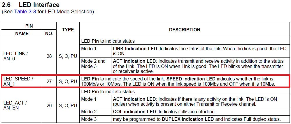

    May I have once more confirmation?
    I am evaluating Profinet and Ethernet/IP.
    In ICSv2, The connection is following:
    It seems ICEv2 is NOT supported 10Mbps operation.
    Because, when it operates as 10Mbps, TLK110 LED_SPEED pin will assert low to PR1_MIIx_RXLINK in AM335x.
    It means RXLINK is not detected.
    Is my understanding right?
    Best regards, RY

  • RY,
    the schematic of the board is one thing. But it is still a question if the (PRU) software evaluates the RXLINK signal. I assume this would be protocol dependent. For example for Profinet 10Mbps is not an available option. I don't think we are using RXLINK in our Profinet device implementations.
    Actually for Ethernet/IP we need to support 10Mbps but I am not the expert here.
  • Frank-san,
    Thank you so much!!
    Your answer is very helpful. I could understand.
