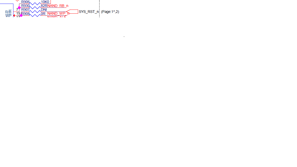

Can you help how to know which pin should be pullup/down? Also, how to identify the base address of NAND?

    You need an external pullup resistor on GPMC_WAIT0. What software are you using?
  • Hi Biser,
    we  are using AM335X_StarterWare_02_00_00_07 code.. GPMC_WAIT0 is connected to R/B of NAND flash.
    Please find the below diagram..
    The wait0 is Pulled up with a 10K Resistor.  Please find the Below image.
  • Are there 82Ohm serial resistors on the NAND signals? Try replacing them with zero Ohm.
  • Dear Sir,
    We replaced the 82 Ohms with 0 Ohms. Even though its Not working. Please find the attached code for your reference.
    Kindly do us favor.
    With Regards
    Umamageswaran. M

  • uma mageswaran said:
    Dear Sir,
    Kindly do us favor.
    With Regards
    Umamageswaran. M

  • Hi Biser,
    Adding to the above comments from Uma :
    We tried as per request of using 0 ohms instead of 82 ohms, still the behavior is same,
    we found that CS is not enabled by GPMC controller when we tried to read ID of NAND flash chip from AM3352.
    Please reply back asap.
    Satish
  • Probably the GPMC initialization is not correct. This forum only supports Linux. For Starterware questions please go to http://e2e.ti.com/support/embedded/starterware/f/790.aspx
