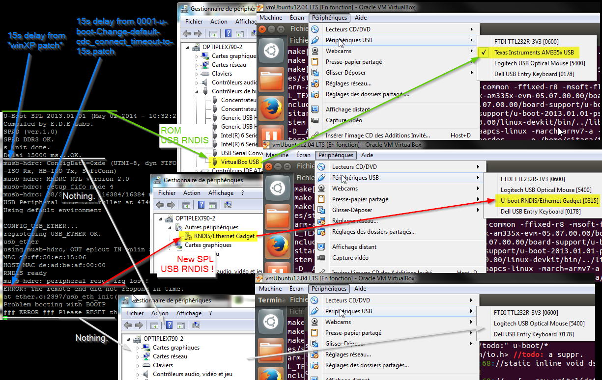

  • I tried with 15s, then with 30s, the usb0 interface is never back !
    It doesn't work.
    When I start my custom board, it takes less than 5s for the host (linux virtual machine) to detect the new usb0 interface (coming from the ROM code execution).
    The stange thing is that when looking at the Windows 7 (physical PC) device manager, a "virtual box USB" appears when my custom board starts and disappears few seconds later. But it never appears again, except if I restart the custom board. Therefore, I wonder if it's just a question of delay.
    Does this correlates with the problem you saw on Windows XP machines ?
    BR
    Didier.
  • Didier,
    Can you tell this "Virtual box USB" is ROM or SPL usb0 interface?
    If it is SPL usb0, then this is not the same issue as what we observed (then my patch will not fix it). If so, please debug in the Virtual Linux if it sees the usb0 as while, and then use for example Wireshark to debug why Linux does not response to dhcp/bootp request.
    Ok, I think it is easy to tell. Use my patch to add a delay to bring up usb in SPL. Then if
    - the usb interface shows up on host when power on the board - this is the usb0 from ROM;
    - then the board boots to SPL, the usb interface disappeared for a 5 seconds, which is the delay from the patch;
    - then the usb interface shows up on host again, this is the usb0 from SPL;
    - then after a few seconds the usb interface disappeared for ever, this is because the host does not respond to the DHCP/BOOTP request.
    If so, this is most likely a host configuration issue, you can debug it with for example Wireshark.
  • When watching traffic on usb0 interface using wireshark, i don't see any bootp request coming from u-boot SPL.
    So I suppose it's not a host configuration problem.
    To get more data, I'm trying now to use Windows servers instead of linux, but it doesn't work :
    The bootp server (opendhcp) responds to the custom board bootp request and a new IP address is allotted (192.168.3.22), but the tftp server (opentftp) doesn't answer anything.

  • Bin,
    Your last post helped me a lot.
    I watched with an increased attention the USB peripherals list in the device manager of the physical machine during the complete u-boot SPL execution. I discovered that during a short period of time (15s of the first patch I applied) a new USB peripheral appears in the list, and then disappears (when u-boot SPL displays error messages).
    (sorry for the low resolution, the forum doesn't allowed me to insert it in its original size)
    Now I know that the new peripheral is here, so it will be far easier to continue.
    Thank you.
    I will try now to attach this new peripheral to the virtual machine, and then to configure an associated network interface Inside the virtual machine.
    I will inform you about progress.
    BR
    Didier
  • It works better !
    After temporarely modified the delay to have time enough to configure my virtual machine's network connections, the u-boot SPL is now able to run to end and download the final u-boot and start it.
    Lines modified to enable an increased delay :
    u-boot/drivers/usb/gadget/ether.c:113:#define USB_CONNECT_TIMEOUT (300 * CONFIG_SYS_HZ) //todo: restore 15s.
    u-boot/net/net.c:392:     puts("300s extra delay\n");//todo: to be suppr.
    u-boot/net/net.c:393:     mdelay(300000);//todo: to be suppr.
    Thank you so much again.
