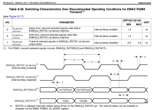

I tried the DM8147 CPRGMII Internal Delay Mode by changing GMII_SEL reg.
But the timing of signals output from rgmii interface does not change at all.
Is there something wrong?
GMII_SEL is 0x0000030a in the image below, so the rgmii is in the Internal Delay Mode.
GMII_SEL is 0x0000033a in the image below, so the rgmii has No Internal delay.
The pink one is RGMII0_TXD2, the blue one is RGMII0_GMTCLK, and the yellow one is RGMII0_TXEN.
There is really nothing different between the two images!

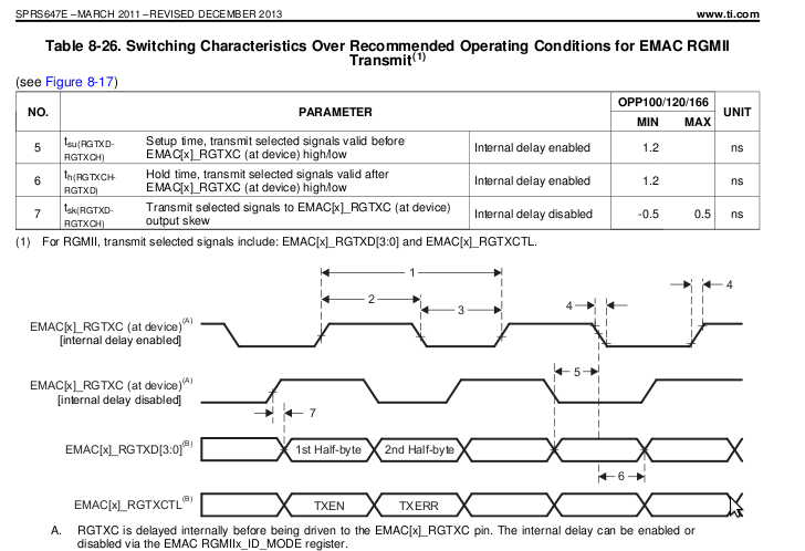

    The signal which is affected by the GMII_SEL internal delay feature is EMAC[x]_RGTXC. See DM814x datasheet (screen shot below):

    From what I understand you are monitoring three signals on the scope: RGMII0_TXD2, RGMII0_GMTCLK and RGMII0_TXEN.
    While the changes between "internal delay" and "no internal delay" modes should be into the EMAC[x]_RGTXC signal.
