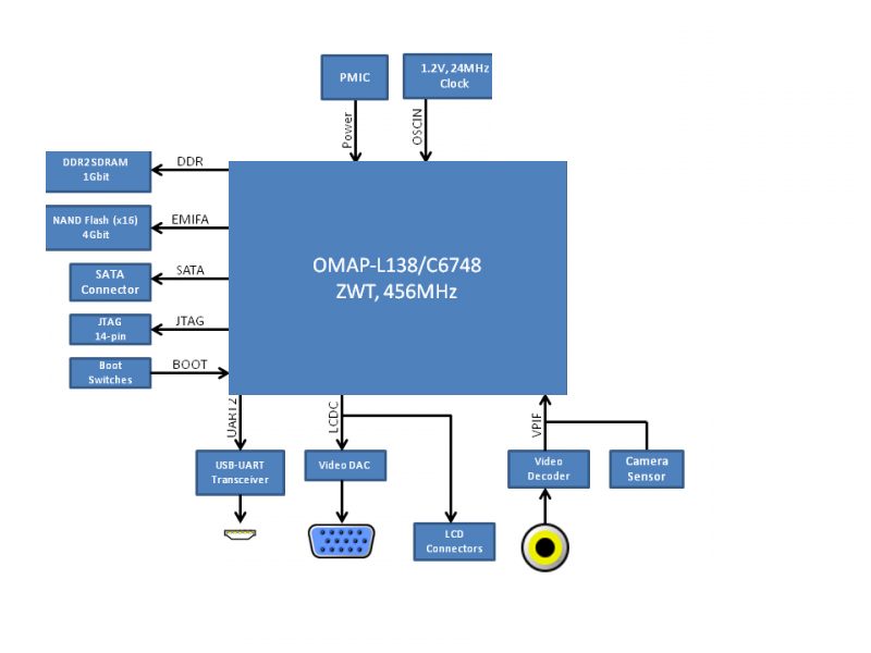

You can do as you describe above, use the EVM for development and then design/build your own board. Since it can be difficult to design with the high-speed signals and small dimensions of the C6748, you may want to look at some of the C6748 SOM (silicon on module) products that can be added to your own board more easily than designing the high-speed portion of the board.
The EVM can be viewed as an example of how to use various peripherals. If you can do it, the best method for you would be to remove the peripherals you do not need, but use the same ones connected in the same way as they are on the EVM. This will improve you chances for quick success in your product.

The EVM Booard :
I would keep the component that i will need to do video process and make my own board :
Wich components i shoud keep. Do you have the reference of components ?
