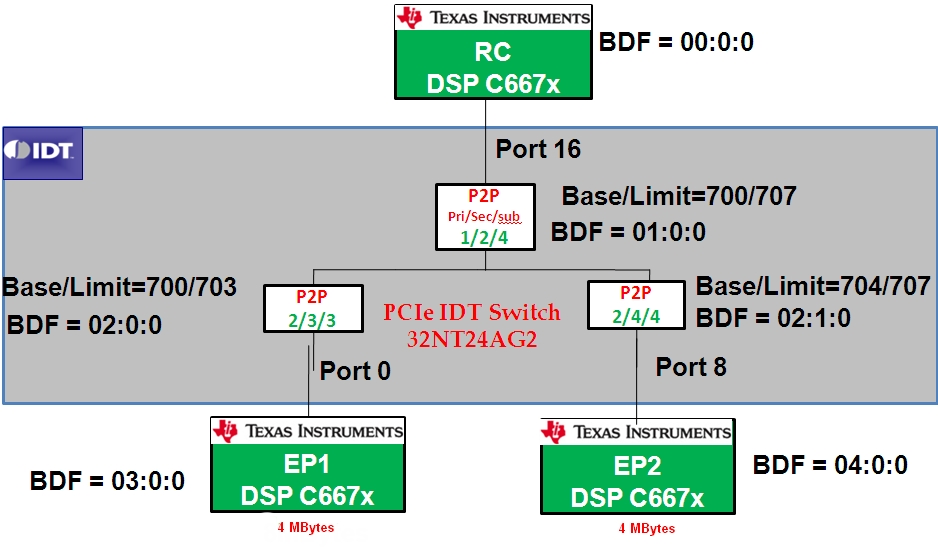

I'm using PCIe interface of C6678 DSP , for communication between two DSP "RC to EP" whit the IDT switch
But I still have the problem with Memory Read and I think it's a routing by ID problem, because I already passed the other transaction as Memory Write AND MSI interrupt.
Currently I have a question about configuring Request ID in each DSP I using TI provide MCSDK PCIe example project.
And I did not find the function that used to configure the requester ID field of the TLP header, I think maybe the problem just here.

  • Hi Ganapathi,
    Thank you for your response, In order that you could understand my problem I am attaching a figure illustrating my settings. I would like to send a memory read from EP1 to RC. So I need to put in the packet request an address from where I want to read (this is not an issue), but I also need to give to the RC, the request IR of EP1 (which is in this case 03:0:0). My question is where I can configure the request ID in the MCSDK PCIe example project.
    Fig. Enumeration setup

  • Hi Zakaria,
    The EP (Requester) tries to send memory read request to RC (Completer). The transaction layer in EP will create the TLP with request ID in its header automatically. But if EP needs to know its own Bus number/Device number/Function number ahead of time.
    Based on PCIe spec, before the first type 0 configuration write is performed to a function, it does not know the bus number and device number portion of its ID. While it remains in this state, a function is not permitted to initiate non-posted requests (such as memory read requests).
    Each time that the source bridge for a bus initiates a type 0 configuration write transaction, it supplies the targeted function with the bus number from its Secondary Bus Number register and the number of the device that the function resides within. The function is required to save this information for use in forming its IDs when it initiates a transaction as either a Requester or as a Completer. The information is not saved in program readable registers but rather in a function-specific manner.
    User has the enumeration software on RC/host to initialize the whole PCIe bus hierarchy (switches, EPs) and generate the configuration write transactions to each switches/EPs to assign the correct bus number/device number to them.
    Regarding to how to generate those configuration requests from C66x PCIe as RC, the user could use CFG_SETUP register and specify the target bus/device/function numbers for the target device (switch/EP) and try to read/write to remote device space in MMR (from offset 0x2000 in PCIe MMR space) to generate those configuration requests.
    TI not  provides this kind of RC/host enumeration software. User may need to create their own version in order to initialize the bus and assign the bus/device numbers to each device.
  • Hi Ganapathi
    Thank you for your help and for giving me all the information, Now I understand these points:
    1- impossible to do the scenario where the EP generate Mrd with the code provided by TI.
    2- To realize this scenario, I need to configure CFG_SETUP and generate a configuration transaction type 0 at RC
    Can you confirm me these points?

  • Hi Zakaria,
    Yes, you need to generate those configuration requests.
