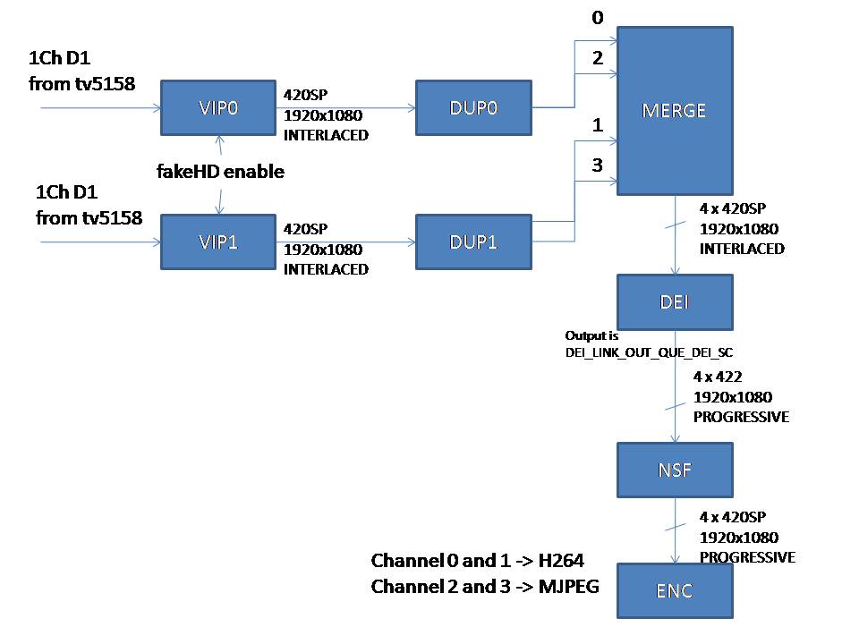

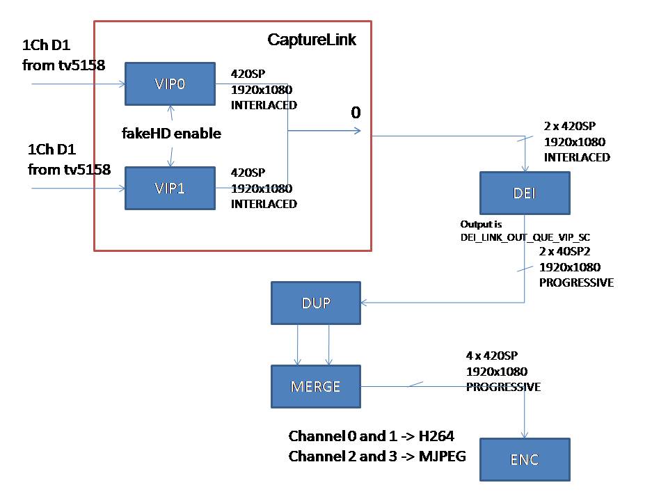

hello,
I am currently working on DVR RDK 4.1 and my target is a DM8107 (CPU 1GHz and 450MHz to HDVICP).
I want to know if it is possible to encode 2x1080p30 H264 and MJPEG 2x1080p30?
I currently manage to make a use case which is 2x1080p30 H264 or MJPEG 2x1080p30 but impossible to make a use case that encodes 4 channels simultaneously.
I do not know if this is due to a problem of resources (I only have 512MB of RAM) or is this a problem for my use case.
I capture two sources VIP0 and VIP1. I duplicate each lane (to obtain 4 lane) and then I sent to a merge.
CAPT (2x1080p30) -> DUP1-> Merge-> DEI-> NSF-> ENC-> ARM (file)
                                    -> Dup2->
The 2 lane in MJPEG are only use to make snapshot JPEG of the 2 inputs streams.
If I reduced the frequency of both channels (10Hz) MJPEG, can it permetre me to run this use case ?
Thank you!
  • Pls attach your usecase file where you are creating and connecting links and the console logs from start of application.
    Why are you doing dei for 4 channels.Do you want to scale each encode channel independently.DEI cant scale 4 ch 1080P in real time
  • Hi Badri,
    I attach my usecase.c and a graph of my use case.

        CHAINS_INIT_STRUCT(CaptureLink_CreateParams, capturePrm);
        CHAINS_INIT_STRUCT(IpcLink_CreateParams, ipcOutVpssPrm);
        CHAINS_INIT_STRUCT(IpcLink_CreateParams, ipcInVideoPrm);
        CHAINS_INIT_STRUCT(EncLink_CreateParams, encPrm);
        CHAINS_INIT_STRUCT(IpcBitsOutLinkRTOS_CreateParams, ipcBitsOutVideoPrm);
        CHAINS_INIT_STRUCT(IpcBitsInLinkHLOS_CreateParams, ipcBitsInHostPrm);
        DeiLink_CreateParams_Init(&deiPrm);
        NsfLink_CreateParams_Init(&nsfPrm);
    /** CAPTURE */
        capture_configure_extvideodecoder_prm(Pt_Conf,_nbChannelEncode);
        capturePrm.outQueParams[0].nextLink = _dup1Id ;
        capturePrm.outQueParams[1].nextLink = _dup2Id;
        capture_set_capture_prm(&capturePrm,Pt_Conf,_nbChannelEncode);
    /** DUPLICATE */
        dup1Prm.inQueParams.prevLinkId  = _captureId;
        dup1Prm.inQueParams.prevLinkQueId   = 0;
        dup1Prm.numOutQue                   = 2;
        dup1Prm.notifyNextLink              = TRUE;
        dup1Prm.outQueParams[0].nextLink        = _mergeId;
        dup2Prm.inQueParams.prevLinkId  = _captureId;
        dup2Prm.inQueParams.prevLinkQueId   = 1;
        dup2Prm.numOutQue                   = 2;
        dup2Prm.notifyNextLink              = TRUE;
        dup2Prm.outQueParams[0].nextLink        = _mergeId;
    /** MERGE */
        mergePrm.numInQue = _nbChannelEncode + NB_SNAP_CHANNEL;
        mergePrm.inQueParams[0].prevLinkId       = _dup1Id;
        mergePrm.inQueParams[0].prevLinkQueId    = 0;
    	mergePrm.inQueParams[2].prevLinkId       = _dup1Id;
    	mergePrm.inQueParams[2].prevLinkQueId    = 1;
    	mergePrm.inQueParams[1].prevLinkId       = _dup2Id;
    	mergePrm.inQueParams[1].prevLinkQueId    = 0;
    	mergePrm.inQueParams[3].prevLinkId       = _dup2Id;
    	mergePrm.inQueParams[3].prevLinkQueId    = 1;
        mergePrm.notifyNextLink             = TRUE;
        mergePrm.outQueParams.nextLink  	= _deiId;
    /** DEI */
        capture_encode_set_dei_prm(&deiPrm, 1920, 1080,Pt_Conf->framerate[0], DEI_LINK_OUT_QUE_DEI_SC );
        deiPrm.inQueParams.prevLinkId    = _mergeId;
        deiPrm.inQueParams.prevLinkQueId = 0;
        deiPrm.outQueParams[DEI_LINK_OUT_QUE_DEI_SC].nextLink = _nsfId;
    /** NSF */
        capture_encode_set_nsf_prm(&nsfPrm, 3, Pt_Conf->framerate[0],Pt_Conf->framerate[0]);
        nsfPrm.inQueParams.prevLinkId    = _deiId;
        nsfPrm.inQueParams.prevLinkQueId = 0;
        nsfPrm.outQueParams[0].nextLink  = _ipcBitsOutVpssId;
    /**IPC OUT VPSS */
        ipcOutVpssPrm.inQueParams.prevLinkId    = _nsfId;

    I reality, I work whith DM8107 DVR RDK from UDWORKS because I prepare functions for my futur custom board which is equiped with a DM8107.
    I capture 2 D1, and I use the fakeHD mode to simulate HD video.
    I use the DEI to transform stream interlaced in progressif at the input of the encoder.
    I don't have the log output today, but I have message "[m3vpss ] 13452: SYSTEM: Opening MsgQ [DSP_MSGQ]..." and finally I got an assertion in ipclink.
    Can you see if there is a problem in my usecase ? Is it possible to do it (4x1080p30) ?
    thank
  • Ok, I have read the doc HDVPSS_FeaturePerformanceGuide.pdf.
    My use case is impossible !
    The max performance of DEI and NSF is 130MP/s.
    I can only pas two 1080p30 (1920x1080x30*2 = 124,4MP/s).
    I have use DEI and NSF because I have now an HW configuration which not permit me to capture 2 videos in 1080p30.
    But whit my future custom board, I will can capture 2 1080p30. In theory, I will not need DEI and NSF.
    In this case, do you think I can do : CAPT (420SP x2) -> DUP(x2) -> MERGE -> ENC (2xH264 and 2xMJPEG) directly ?
    I have a constraint on taking snapshot, I should be able to take an image every 300ms.
    If is not possible, have you an idea for doing snapshots of the two lane which are encoding in H264 ?
    A - Is it possible to use ENC_LINK_CMD_SET_CODEC_SNAPSHOT to do snapshot when encoder is configured in H264 ?
    B - I think, I also can do it with a select link and with the dynamic command ENC_LINK_CMD_SWITCH_CODEC_CHANNEL of enclink but what are the performance of the command ENC_LINK_CMD_SWITCH_CODEC_CHANNEL (delay for switch between H264<->MJPEG) ?
    What do you think about this 2 ideas ?
  • The issue with your usecase is dupLink after capture link has prevLinkId as 1 but all capture channels are output only on que 0.
    Regarding performance 2 ch 1080p30 is possible .I think 6 fps additonal mjpeg will be possible as there is some margin.If you face performance issue we can check other options.
    You can implement capture encode Usecase without nsf and dei as you mentioned.For usecase development on uddvr do dup after dei.You dont need nsf.Set dei output format as yuv420sp and select vipsc outque
  • Hi Badri,
    Thank for the response.
    Can you confirm I have well understood that you said about my use case on dvr (a drawing is better than a long speech I think !):
    I can't test it today, but tomorrow I come back to you for the result of the test.
    thank again
  • Yes your new data flow is exactly whatI meant.Do you require snapshot at periodic interval or is it based on user action.Can you set your h264 IDR interval to 300ms.The IDR could be used as snapshot.

    LOG :  ipcBitsInVideo to Encoder
    LOG :  Configure Encoder 0 in H264
    LOG :  Configure Encoder 1 in H264
    LOG :  Configure Encoder 2 in MJPEG
    LOG :  Configure Encoder 3 in MJPEG
    LOG :  Encoder to ipcBitsOutVideo
    LOG :  System_linkCreate _captureId

     [m3vpss ]  90384: Assertion @ Line: 289 in links_common/system/system_ipc_msgq.c: 0 : failed !!!
    I don't understantd why there is [DSP_MSGQ] !!!
    I think is a problem with the IPC link id but, i don't see my error.

  • The nextLinkId is wrongly set to 0 for one of the links. Based on your previous usecase file looks like dupLink is the issue
     dup1Prm.outQueParams[0].nextLink is set but  dup1Prm.outQueParams[1].nextLink is not set.
    I see same issue for dup2Prm as well
  • Thanks again Badri,
    You have found the error !!
    I will continue my tests and I will come to you if I have any other problems or to give you the results.
