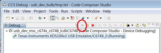

Dear All,
I fail to run the C6748 Starterware example usb_dev_msc on LCDKC6748. In CCS I can build usb_dev_msc, connect to LCDKC6748 via JTAG (Below is the output message from Console),
C674X_0: Output: Target Connected.
C674X_0: Output: ---------------------------------------------
C674X_0: Output: Memory Map Cleared.
C674X_0: Output: Memory Map Setup Complete.
C674X_0: Output: PSC Enable Complete.
C674X_0: Output: PLL0 init done for Core:372MHz, EMIFA:SYSCLK3=93 / DIV4P5=82.67 MHz
C674X_0: Output: DDR initialization is in progress....
C674X_0: Output: PLL1 init done for DDR:132MHz
C674X_0: Output: Using mDDR settings
C674X_0: Output: mDDR init for 132 MHz is done
download Debug\usb_dev_mcs.out, but then fail to run. The following screen shot depicts this symptom:
As you can see, the Resume icon is disabled, as well as the run cursor doesn't appear and stop at the main() function.  And I also find that, if I modify the main() function like:
    while (1);
  USBDMSCInit(0, (tUSBDMSCDevice *)&g_sMSCDevice);
The additional while (1); prevents the function USBDMSCInit() to be called and then Resume icon will be enabled. As other example code, such as usb_dev_serial, work perfectly, I think this should not be an hardware issue.
I'll appreciate if anyone could advise. Thanks in advance!
Oliver

  • Dear Shankari,
    First thank you for your prompt reply and comments.
    According to your comments, again I import the existing C6748 Starterware usb_dev_msc sample project, create a target configuration (*.ccxml) with XDS100v2 emulator and (C6748) LCDK, create a debug configuration with the target configuration just created, start to debug this project on LCDK. Finally this program starts to run and attaches to PC Host as a mass storage device. Thanks to your suggestion!
    I think the symptom I described in my last post was caused by the inappropriate target configuration file. My goal is to run the usb_dev_msc code on our own board, rather than LCDK. Though I have a target configuration file which fits other example code, e.g., usb_dev_serial, running on our own board, that target configuration file seems not fit usb_dev_msc. The symptom is what I described in my last post.
    1537.target_configuraiton.zip
    You can find the target configuration files I used in the attached zip file:
    lcdkC6748.ccxml: The file that fits LCDK
    EVK29_emul.ccxml & EVK29.gel: The files that normally fit our own board
    Could you advise how to solve this issue?
    Oliver

  • Dear Titus,
    Now I've identified that the GEL file I've used for a long time on our own (custom) board doesn't get along with the Starterware example code usb_dev_msc. Now I'm comparing it with the pdk_C6748_2_0_0_0\C6748_StarterWare_1_20_03_03\tools\gel\C6748_LCD.gel, because C6748_LCD.gel works smoothly with usb_dev_msc.
    Anyway, thanks for your reply and help!
    Oliver
  • Dear Titus & Shankari,
    Finally I find the root cause of this symptom. In the file ramdisk.c a 16 MByte of buffer is declared:
    #define RAM_DISK_SIZE (1024 * 1024 * 16)
    unsigned char ram_disk[RAM_DISK_SIZE];
    This is OK for LCDK because it owns 128MByte DDR2. However, on our board there is only 8 MByte mDDR. Decreasing this buffer to 1M Byte solves this issue: The Resume icon in CCS Debug perspective will be enabled after downloading .out file to C6748.
    Thanks for all your kind help! :)
