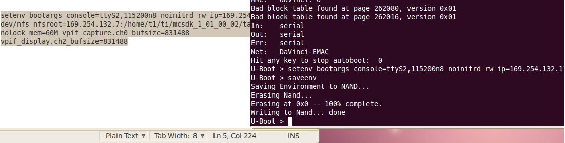

I am a new user for omapl138 lcdk, dont know much about linux. Recently i want to capture video with V4L2 driver and a pal camera, I use the following document to set my own project. But i can not find the video driver in the dev directory, i can find this driver by this command "cat /proc/devices". I find "81 video4linux", and i use the command " mknod video0 c 81 0" to create nod. The video0 can not be used."can not open......" is displayed. So i need some help to slove this problem. Thanks in advance.
http://processors.wiki.ti.com/index.php/Demonstration_of_VPIF_raw_capture_using_MT9T031_sensor_on_AM18X/DA850/OMAP-L138_running_Linux
  • Hi Hui,
    What is your camera part no?
    Have you modified the your board file (pdata) for your camera hw?
    Could you please attach your bootup logs?
  • (1) I am sorry, my english is not good, i can not understand the first question. I guess, what you want to know  is that a pal camera is connect to the compostite port and tvp5147m1 decoder. The camera is not ti UI board. The same connection in sysbios project can get a good result.
     (2) what is the board file(pdata) in linux? i am sorry, i am not familiar with linux.I don't know how to modify it. I just modify the menuconfig and bootargs according to the document.
     (3)

    U-Boot > printenv
    baudrate=115200
    bootargs=console=ttyS2,115200n8 noinitrd rw ip=169.254.132.11 root=/dev/nfs nfsroot=169.254.132.7:/home/t1/ti/mcsdk_1_01_00_02/targetNFS, nolock mem=60M vpi2
    bootcmd=if mmc rescan 0; then if fatload mmc 0 0xc0600000 boot.scr; then source 0xc0600000; else fatload mmc 0 0xc0700000 uImage; bootm c0700000; fi; else si
    bootdelay=3

  •  Hi, after setting the menuconfig again,the same error occurs.Could you help me to check the error. Thanks.
       1.set systemtype to vpif
      2.disable the fb
     3.select multimedia surport
    4. select video for linux
    5 select v4l platform devices(video display, video capture, vpif driver)
    6 select tvp514x decoders
    7 set bootargs

  • Hi, thanks for your reply.my sdk is mcsdk_1_01_00_02.
    After changing menuconfig in the figures, the vpif bootup is same as the former. Only one line "Linux video capture interface: v2.00".
     But the video0 can be registered when i enable "Magazine Virtual Video Capture Board". When i want to set it again, i can not find the option "Magazine Virtual Video Capture Board". I don't know the reason.
    video1 can be registered when i enable the "mem2mem". I can not find the video2 which is used for display.
    In mcsdk, this is no omapl138_lcdk_defconfig, so i use the da850_lcdk_defconfig.
    I enable the tvp514x decoder.
    I want to know, ti has no other vpif document for omapl138 lcdk? In mcsdk userguide, ti remonmend the document which i used for the first time.
