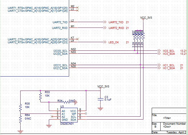

I2C cannot work
Hi all
This is my  i2c register config according to datasheet

when I run the demo, the function EVM816x_I2C0_write() return 2002, I debug the problem is the status of the  I2C0_STAT does not change, so why it does not change? how should I can do for that?

  • Zhong,
    Can you describe the problem clearly? Its very difficult to understand what exactly you are trying out on I2C0. What is the software stack that you are using? Is it Linux?
  • Hi Renjith,
    Thanks for you replay.
          The problem is that I have a chip loaded on I2C in dm8168 ,it's  i2c address is 0x55. I want to use I2C0 getting the chip ID. I load a ccs test program of dm816x, I see there is a test demo i2c_mapper. Of course, the demo is not woking in my SEED-XDS560 simulator, so I create a c6000 project according to the demo i2c_mapper.There are my files, could you please check them out for me how should I modify it,thanks very much.

    Can share the portion of the schematics, that is connecting your slave device to DM816x? Also can you confirm if you are using I2C0, you are initializing or following the reset sequence correctly?
  • Renjith,
    Here is the schematics.
    When I run the linux I2C driver, is it need to do i2c0 initializing?
    There is a init function(EVM8168_I2C0_init()) in the demo, what else init I can do for I2C0?
    So, what do you mean that  'can you confirm if you are using I2C0, you are initializing or following the reset sequence correctly'?
    Thanks.
    Best Regards
    Zhong
  • Zhong,
    If you are using DS28CN01 as slave, then its connected to I2C1. Also the address 0x55 doesn't seems to be correct according to A0, A1 pins. If its different can you share the slave side schematics as well?
  • Renjith,
    Thanks for your replay.
    The schematics I have shared is the chip DS28CN01 side schematics.
    According to A0, A1 pins, the address should be 0x2a, is it right?
    Ok, I will use i2c1.
    Thanks.

  • I think the address will be 0x50 (7-bit) because AD0 and AD1 are grounded. Please cross-check once again. If you can run i2c probe on I2C1 it will tell you the exact address.
  • Renjith,
    Yesterday I have run the i2c probe, and getting the address 0x18、0x68, do you mean that command was running on i2c0? If it is, how I can do to change from i2c0 to i2c1?
    Thanks.
    Best Regards
    Zhong

  • Renjith,
    Now I can run the i2c1_mapper in ccs, the problem is that I did not choose the i2cclkenable on scripts.
    But now I meet a new problem, I can run the demo in ccs by choose i2cclkenable, if not in ccs, how  I should load i2cclkenable.
    Thanks.
    Best Regards
    Zhong
  • Zhong,
    Good to know that you are able to make progress. I would still recommend you to stick to u-boot or Linux as there is no much benefit in re-developing the I2C driver yourself. You can try to resolve the issue in accessing I2C device.
