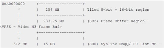

in the 8168 memmap,a SR2 section
in the dsp process link,when get the NEW_DATA CMD,i send the phyaddr of video frame to A8,but A8 can
not access the value of the phyaddr.why? A8 can not access the phyaddr from dsp link,is it?
but if in the M3 VPSS DUP link,when it get the NEW_DATA CMD,i send the phyaddr of video frame to A8,A8 can access the value of the phyaddr.And both of the phyaddr of video frame in the DUP link or process link are in the same section SR2.
  • Are you mmaping the physical address before accessing its user virt address ? Does  mmap fail for phyaddr received from c674 dsp.What is the value of phyaddr
  • I don't need to use memmap I use devmem2 to look the value of phyaddr ,it is a cmd in linux ,can print the value of phyaddr if in m 3. Dup link send as i said ,it is right 。 i want to know does. a 8 can access the phyaddr of frames send from dsp best regards
  • Yes a8 can access frame sent from dsp.It is just ddr address .Any core can access.If you are unable to access it means address is wrong.It has nothing to do with c674 dsp.Share devmem2 log for working and not working case

    /dev/mem opened.
    Memory mapped at address 0x40326000.
    Read at address 0xB045E280 (0x40326280): 0x02020202
    /dev/mem opened.
    Memory mapped at address 0x401c3000.
    Read at address 0xB0166C80 (0x401c3c80): 0x02020202
    /dev/mem opened.
    Memory mapped at address 0x40243000.
    Read at address 0xB01E5580 (0x40243580): 0x00000001
  • You have to make the cache coherent by doing Cache_wbInv for contents to be moved from c674 cache to ddr.Refer algLink scd process function
  • thanks for your reply.
    but in my code,i just modify the value of phyaddr,do not use the variable.
     *(int *)Ch1BufPtr_phy=1;
    best regards.
