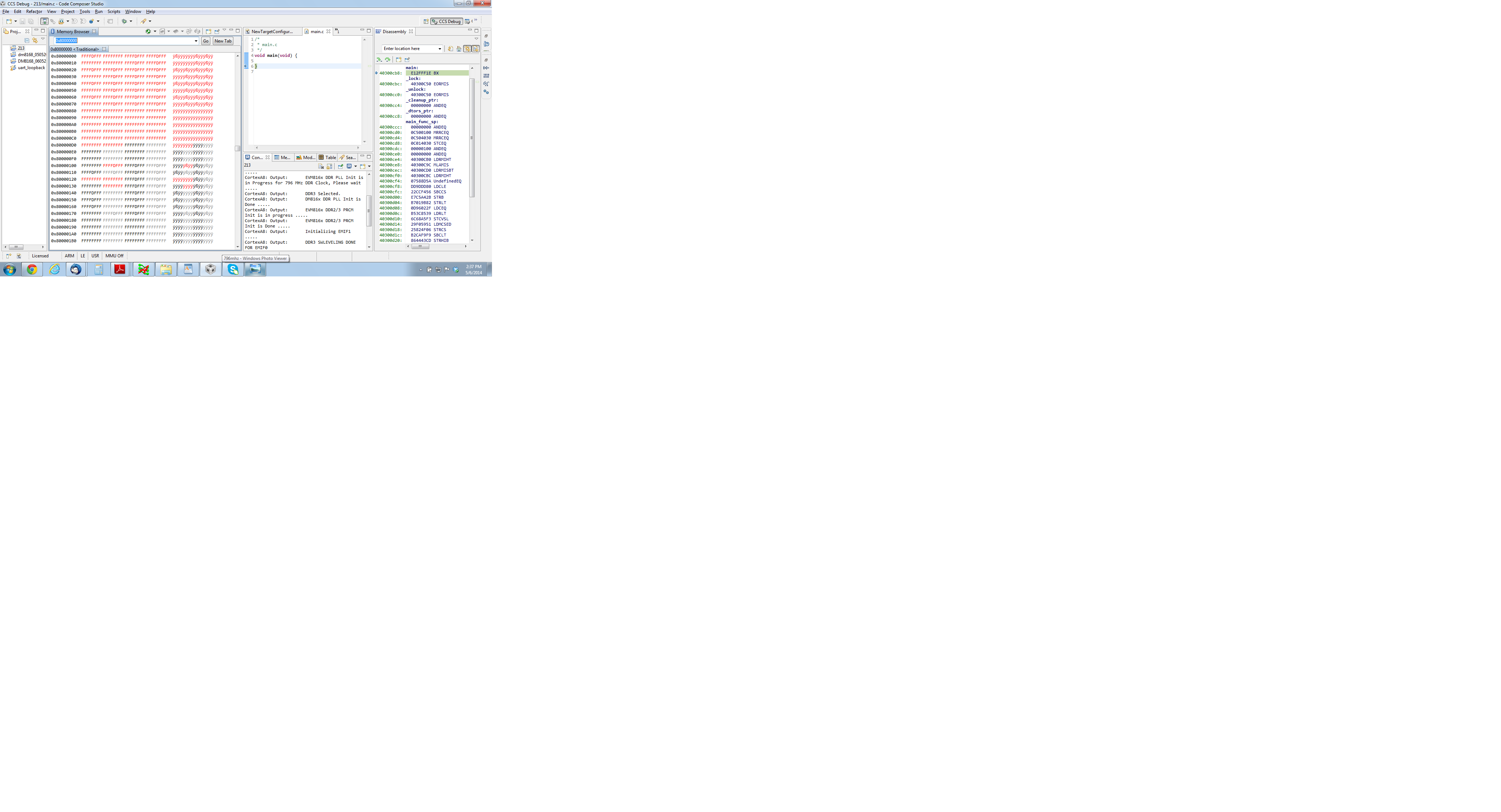

We have made 4 DM8168 boards in sets of 2 each. The first 2 boards worked perfectly, we are having issues in bringing up the second set of 2 new boards. The build in boot code loader sequences through both NAND and SD card Image but the COM2 port does not come up.Our design is similar to EVM. where we have boot indicator LED (i.e. to L9(UART2_RTSN/GP1[23]) BGA pin of processor). So with SD/NAND boot modes LED is blinking and verified same with EVM board, But not able to see any data on UART2. And on UART0 (with 00001 boot mode switch setting) able to see continuously printing 'o' character with 115200 baud, 8-bits, even parity, 1 stop bit configuration. We are able to see mmc data/clock activity on SD card.
Suspecting DDR issues, via CCS we tried to fill memory from 0x80000000 to some locations with 0xFFFFFFFF data (we have 2 banks 0f DDR3). Here bit 13th is toggling to first 128 address locations (i.e. from 0x80000000h to 0x8000007Fh) and next 128 address it is fine (i.e. from 0x8000080h to 0x800000FFh) and it is continuously in loop.for more information attaching snap of memory browser.
We assumed it to be address data short (assembly issues) and tried memory 0xc0000000 too, same behaviour. Looks like its a timing issues. Played around a bit with RAS CAS timings...Nothing seems to help.

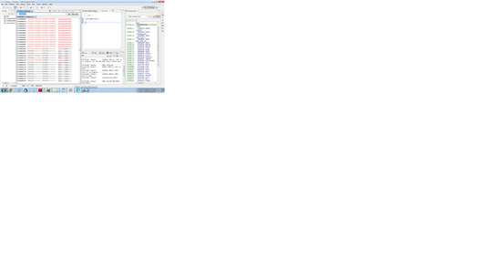

        We are loading evm816x.gel (Version 1.02) file.and it correctly initializing.we tried with different DDR frequency and with 'DM816x_C6A816x_AM389x_EMIF4_Register_Settings' file, We tried to change parameters like CL, CWL, IBANKPOS,SDRCR and Timing parameters etc but no change.
       We are using DDR of micron (part no.MT41J256M8HX-15E:D) and design similar to EVM board. After loading GEL file, through memory browser, filling memory from 0X80000000 locatiion to  next 1000h location with FFFFFFFF value. In result it, from 0X80000000 to 0X8000007F it is writing as FFFFDFFF  and from 0X80000080 to 0X80000100 it is writing as FFFFFFFF and it's in continuous loop of 128 address. for more information attaching the snap of memory browser. so, here its looks like assembly issue. from this clue how can i find which address or data line short or it is causing due to some other issues ?

    the snap
  • Bear in mind that the EMIF controller will interleave data writes between the 2 banks of memory (if you have 2) which explains the looping you are seeing every 128 bytes. I'm confused as to why the apparent open-circuited data line (from the "D" in FFFFDFFF) is only affecting certain addresses though. I would have thought this would affect all addresses.
    I think you need to fix your "assembly issue" first so that you can be sure the memory has been zeroed correctly before writing the 0xFFFFFFFF everywhere. Could you fill in a memset and a "for" loop in your C program and execute that over JTAG?

      Here one more thing is observed is that, In memory browser whenever i am filling or changing some value this "D" bit is toggling (D-->F or F-->D)which is affecting entire 128 byte of addresses (i.e. from 00 to 7F). So is there any possibilities of open adderess/data lines of DDR?

  • First of all, I would say that bit 21 of your data bus is broken. It's either floating or shorted to ground. This assumes your system is set up little endian.
