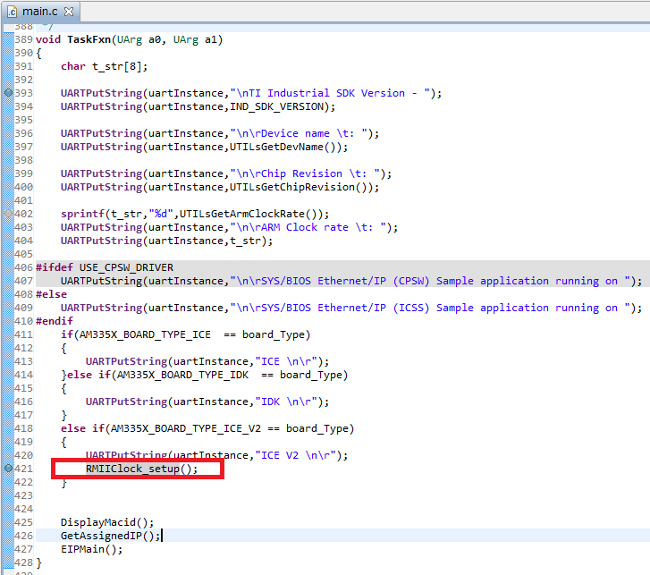

I am evaluating ethernetip_adapter example in ISDK v1.1.0.4.
When I use ICEv2.1, RMIIClock_setup() function is always performed.
It configures Clock IC(CDCE913) as 50MHz operation, which is used by TLK110 RMII mode.
However, PRU-ICSS is supported only MII mode.
I can not understand why this function is called in example.
Is this RMIIClock_setup() function needed for PRU-ICSS ethernetip operation?
Best regards, RY

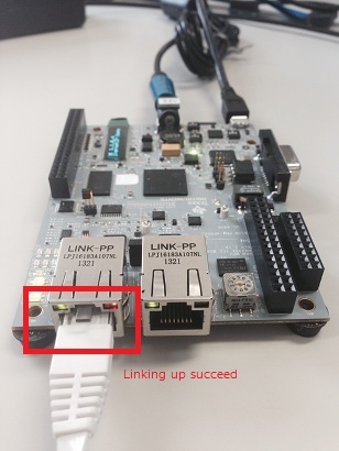

    It is additional information:
    When ethernetip_adapter demo do without any modify, RJ45 fails linking up and ping can not be transmitted from PC to ICEv2.1.
    When I comment out RMIIClock_setup(), RJ45 succeed linking up and ping can be succeed too.
    Capture image is following:

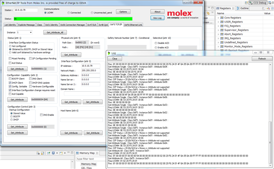

    I also examined using EtherNet/IP tool which can be download from following url:
    EtherNet/IP Tool
    http://www.molex.com/molex/common/staticLoader.jsp?fileName=/mx_upload/superfamily/iccc/EtherNet_IPTool.html
    Although I am not familiar with this tool, ICEv2.1 can respond some packet.
    Therefore, I think RMIIClock_setup() is not needed for PRU-ICSS operation.

    Thank you very much for pointing out this with the details. As you mentioned, 'RMIIClock_setup()' function is not needed in ICSS mode. Actually it should have come under the macro 'USE_CPSW_DRIVER'. We will track/ followup with this bug internally.

    We can communicate with the board (ping as well as EIP tool) with the released app as well as by commenting out 'RMIIClock_setup()' in 'TaskFxn' in main.c - We believe this behavior caused us failing to find this bug during our testing.

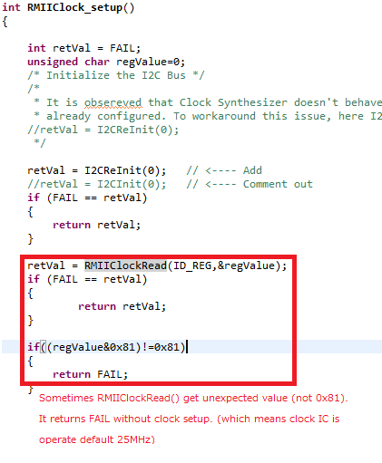

    I could sometimes see failing of I2C transfer in RMIIClock_setup().
    For detail, RMIIClockRead() sometimes get unexpected value(not 0x81) in following source code.
    It returns FAIL without clock setup. (which means clock IC is operate default 25MHz)
    Best regards, RY

    • In this scenario, RMIIClockRead() function reads a value 0x81 in regValue. Hence the CDCE913 Clock Synthesizer IC is setup to operate in RMII Clock frequency 50MHz.
    • When the ARM clock rate is configured to 600 MHz, the RMIIClockRead() function reads a value 0x46 to regValue. So the CDCE913 Clock frequency setup routine is not executed and the CDCE913 operates in default 25Mhz. Here the EVM links are up and we can communicate well.
    RMIIClock_setup(); is not required in ICSS mode. It should be under the macro 'USE_CPSW_DRIVER'. When we do that, it is observed that EIP communication is OK when the ARM clock rate is 600 MHz or 300 MHz.. So we will fix this bug in next release. (SDOCM00108035)
