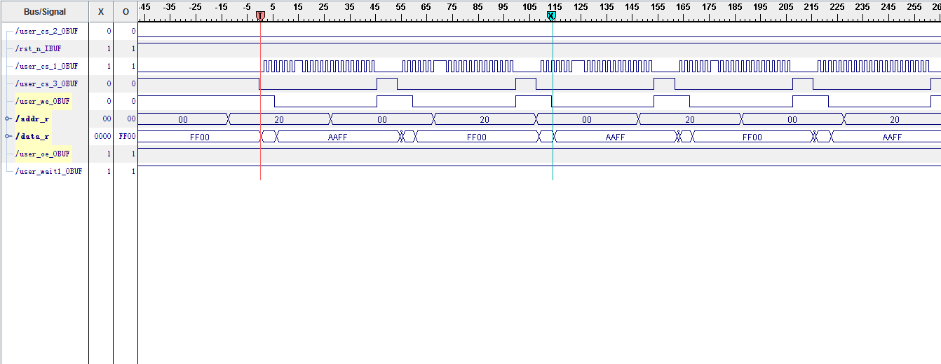

Recently, I am going to realize the data transfer between AM335x and FPGA via gpmc. And got some trouble of the burst writing mode. I want to use burst writing mode. When I finish configing the GPMC registers Config1~Config7, the result got by FPGA shows that it is still in single writing mode. Can any one help me?
This is my config code:

The result got by FPGA is as follows:
the picture shows that the gpmc_clk is 100MHz, it is in single mode ,why ,can anyone help me ?
