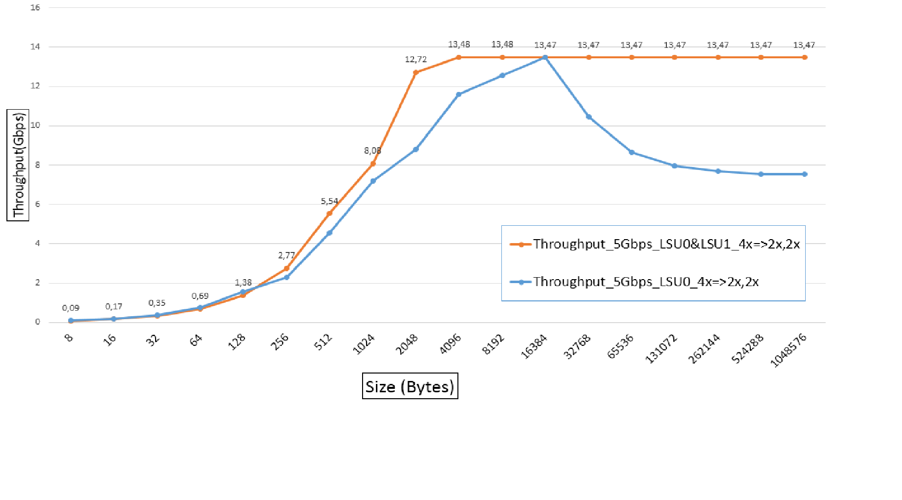

i'm testing Srio performance using two differents scenarios ,
In the first case i have 2LSUs that shared the same port and send data throught  switch "sps1848" to 2 different destinations (A,B), the sending is on 4X and reception in 2X for each destination .
In the second case i have 1LSU that send data throught switch to 2 different destinations (A,B) , the sending in on 4x and reception on 2x for each destination .
I can't find an explanation for the result i got : => here are curves showing results
I can't explain ! why does the throughput drop when the data exceed 16KB when using 1LSU !!
 Thank you in advanced!
Asma

  • Hi Ganapathi,
    thank you very much for your answer , i can understand the throughput dropping but i can't see why is it exactly at 16 KB ??

  • Hi Asma
    I do not think it's a problem of shadow register, I had done some SRIO throughput test some time ago and the speed tended to stabilize at a value of about 13 gbps, regardless of the number of shadow register associated, and i was using a single LSU
  • Hi Henry ,
    Thank you for your answer , i share your opinion and i don't think it's a "shadow register"  problem.
    In fact i've done a first test with 1LSU sending data to one destination (4X=>switch=>4X) and the throughput stabilized at 13 Gbps , but during the second test when i send data using 1LSU to 2 differents destinations  (4X=>switch =>2X,2X) the troughput drop after sending 16 KB  this is why i'm wondering why the dropping started after 16KB and not any other value .
    Waiting  for your answers
