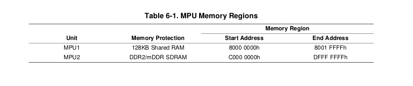

    So the question is what makes 0x80000000 ok and 0xc3000000 wrong? Is it part of syslink build or kernel build?
    0x80000000 is shared RAM for DSP as well ARM
    0xc3000000 is DDR/mDDR RAM address location
    So, Please make sure that your DDR memory is not conflict with DSP mapping.

    MemoryOS_map: entry already exists
    mapInfo->src [0x1c00000]
    mapInfo->dst [0xfec00000]
    mapInfo->size [0x400000]
    OMAPL1XXPROC_attach: Mapping memory regions
    OMAPL1XXPROC_attach: slave is now in reset
    ProcMgr_getProcInfo: bootMode: [0]
    OsalDrv_mmap(): setting cache disabled for physical address 11800000
    OsalDrv_mmap(): setting cache disabled for physical address 11f00000
    Attached to slave procId 0.
    Loading procId 0.
    _Coff_getSymTabDetails: Number of symbols: 16588
    _Coff_getStringTable: String table [0xc8eaf000]
    _Coff_getSymbolTable: Allocated memory for the symbol table
    _Coff_getSymbolTable: Seeking to the location of the symbol table
    _Coff_getSymbolTable: Reading symbol table into memory
    _Coff_getSymbolTable: Start of string table [0x1f2c65]
    _Coff_getSymbolTable: Updated numSymbols after reading symbol table [14684]
    Coff_load: Number of sections: 22
    _Coff_getOptHeaderSize: Optional Header Size: 28
    MemoryOS_map: pa=0xc30bc800, va=0xc8f8c800, sz=0x34
    _ProcMgr_map for SlaveVirt:
    dstAddr [0xc30bc000]
    sgList.paddr [0xc30bc000]
    sgList.offset [0x800]
    sgList.size [0x834]
    MemoryOS_map: pa=0xc30b8180, va=0xc8f90180, sz=0x2000
    dstAddr [0xc30b8000]
    sgList.paddr [0xc30b8000]
    sgList.offset [0x180]
    sgList.size [0x2180]
    MemoryOS_map: pa=0xc30bc468, va=0xc8f96468, sz=0x39
    sgList.offset [0x468]
    sgList.size [0x4a1]
    MemoryOS_map: pa=0xc30ba180, va=0xc8f9c180, sz=0x1e3c
    dstAddr [0xc30ba000]
    sgList.paddr [0xc30ba000]
    sgList.size [0x1fbc]
    MemoryOS_map: pa=0xc30bc4a4, va=0xc8fa04a4, sz=0x8
    sgList.offset [0x4a4]
    sgList.size [0x4ac]
    MemoryOS_map: pa=0xc3000000, va=0xc8fa8000, sz=0x6f14
    dstAddr [0xc3000000]
    sgList.paddr [0xc3000000]
    sgList.offset [0x0]
    sgList.size [0x6f14]
    MemoryOS_map: pa=0xc30bc000, va=0xc8fa6000, sz=0x200
    sgList.offset [0x0]
    sgList.size [0x200]
    MemoryOS_map: pa=0xc3062fc0, va=0xc9000fc0, sz=0x551c0
    dstAddr [0xc3062000]
    sgList.paddr [0xc3062000]
    sgList.offset [0xfc0]
    sgList.size [0x56180]
    MemoryOS_map: pa=0xc30bbfbc, va=0xc8fb4fbc, sz=0x40
    dstAddr [0xc30bb000]
    sgList.paddr [0xc30bb000]
    sgList.offset [0xfbc]
    sgList.size [0xffc]
    MemoryOS_map: pa=0xc30bc200, va=0xc8fb8200, sz=0x148
    sgList.offset [0x200]
    sgList.size [0x348]
    MemoryOS_map: pa=0xc3006f18, va=0xc9080f18, sz=0x5c0a8
    dstAddr [0xc3006000]
    sgList.paddr [0xc3006000]
    sgList.offset [0xf18]
    sgList.size [0x5cfc0]
    MemoryOS_map: pa=0xc30bc348, va=0xc8fbe348, sz=0x120
    sgList.offset [0x348]
    sgList.size [0x468]
    Loaded file ./Au Coff_getEntryPt: Entry point [0xc30af420]
    dioDsp.out on slCOFF File entry point: [0xc30af420]
    ave procId 0.
    OMAPL1XXPROC_start: Configuring boot register
    Reset vector [0xc30af420]!
    OMAPL1XXPROC_start: Slave successfully started
    Started slave procId 0.
    _NotifyDrv: Termination packet
    Gleb
