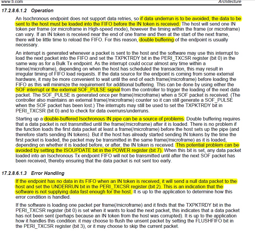

    It seems the next set of 64bytes need to be already present in the FIFO by the time the IN token arrives. Underrun is occurring because data is not being supplied fast enough, i.e. not as fast as expected by the host.
    Could it be possible to update the FIFO again with the next chunk of data before the IN token arrives?
    If that does not work, could you use double-buffering? A few excerpts from the TRM on the same:
    "Double packet buffering: When enabled, up to two packets can be stored in the FIFO awaiting
    transmission to the host. Double packet buffering is enabled by setting the DPB bit of T/RXFIFOSZ
    register (bit 4).
    If double packet buffering is enabled, then after the first packet has been
    loaded and the TXPKTRDY bit set, the TXPKTRDY bit will immediately be cleared by the USB controller
    and an interrupt generated so that a second packet can be loaded into the FIFO. The software should
    operate in the same way, loading a packet when it receives an interrupt, regardless of whether double
    packet buffering is enabled or not.
    NOTE: It may be necessary to set FLUSHFIFO bit twice in succession if double buffering is enabled.
    (bit 3 of PERI_TXCSR and bit 4 of PERI_RXCSR)."
    A similar situation is described in the Isochronous usb transmission section of the TRM. Could you please check if the mentioned solutions are able to alleviate the problem?
    Please find below a snapshot of the section. Have highlighted a few keywords/phrases:
    Best Regards.

  • Yes Georgi. EP0 doesn't have double-pkt buffering. Missed that.
    "There is only 1 interrupt for EP0. How can I distinguish when it is for Tx completion? A state machine approach is suggested in the TRM.Unfortunately, the only interrupt I receive after the first 64 bytes are sent, comes with the UNDERRUN flag set."
    When you receive the interrupt, you may check the PERI_CSR0 register for TXPKTRDY bit. If it's shown to have been cleared, then it indicates it's a TX completion.
    You would also note that this register doesn't have any UNDERRUN bit. This bit is present only in PERI_TXCSR registers which cater to EP1-4. You mention that you're concerned only with EP0. So this bit being set in loc. 0x8412 means it's SENTSTALL, not UNDERRUN (refer PERI_CSR0, not PERI_TXCSR).
    PFB a snapshot. The highlighted section might be the cause of this bit being set. Could there be a control from the host side to avoid this additional IN request being sent, as this might be constituting a violation of the protocol set by the command byte sent in the control transaction.
    Best Regards.
