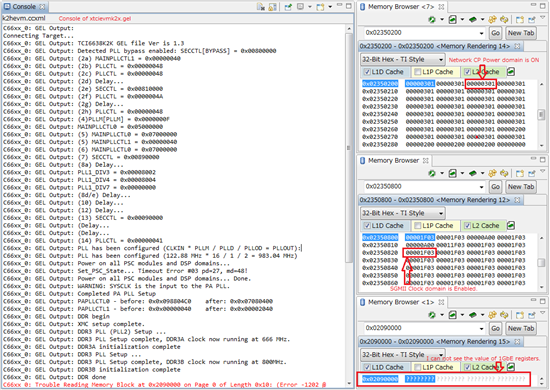

I would like to access the 1GbE registers by CCS memory view.
I configured Power domain "#2:Network Coprocessor" and Clock domain "#8:Ethernet SGMIIs" by GEL(xtcievmk2x.gel).
But I can not see the value of 1GbE registers at address 0x02090000.
Can you point out lack of my configuration?
