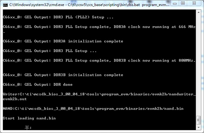

1.when burning nand, the process stop in "start loading nand.bin". Otherwise, I had burnt nand before and i donot know if it matters.

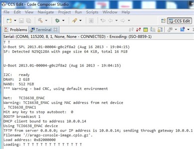

2.This is the boot log,but always in fail. I just cannot understand why my tftp serverip is 0.0.0.0?

    For the Rev 3 EVM, there is a different process you need to follow to program your NAND. See here: http://processors.wiki.ti.com/index.php/Program_EVM_UG#For_EVMK2H. You'll need to set up a TFTP server to do this.
    Additionally in U-boot, you need to configure your environment variables before you boot. The user guide covers some of these variables: http://processors.wiki.ti.com/index.php/MCSDK_UG_Chapter_Tools. Specifically, you'll need to configure at least serverip and tftp_root variables.

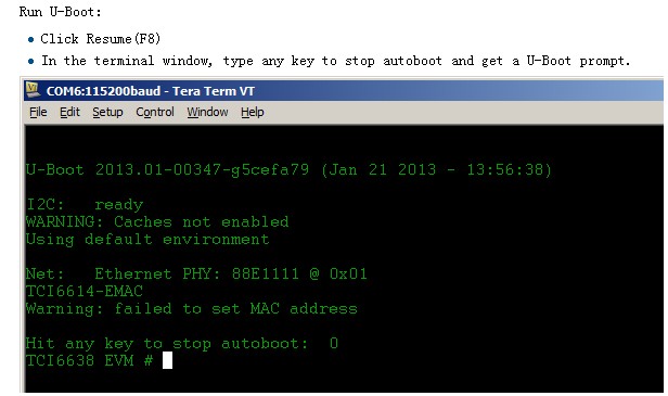

  • Hi Dharik,Thanks a lot for your suggestions. I followed the steps but got into trouble in U-boot. I use the win7 host so I am not sure if the U-Boot bin file is the file located in <mcsdk_linux_3_00_04_18>, but it is the only one. I loaded the bin file in to chip memory with CCS and  the EVM worked with "No Boot/JTAG DSP Little Endian Boot mode". I went through above steps, but I do not known how to get a U-Boot prompt in the end like this demonstrated in http://processors.wiki.ti.com/index.php/MCSDK_UG_Chapter_Tools. Does not it need to change the boot mode switch SW1 in the process? Does not U-boot run in the SPI Little Endian Boot mode?
