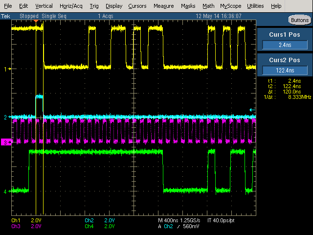

My customer is testing the C6678 TSIP interface via external loopback on a prototype board.  They have a 8.192 MHz single data rate serial clock and a 8 KHz serial frame sync as inputs to the C6678.  They have modified the TSIP_testProject found in pdk_C6678_1_1_2_6 accordingly.  They have placed the C6678 into LLB mode and generate a test tone on TSIP0_TR00 and monitor TSIP0_TX00 for the loopback tone.  However, Section 5.1.3.3, LLB Testing, of the Telecom Serial Interface Port User Guide (sprugy4.pdf) states that:
"Successful operation is determined by comparing the transmit serial links with a delayed version of the receive serial links.”

The oscilloscope capture appears to verify that LLB mode loopback is successful, but they would like to verify this through memory/register inspection.
I've attached an oscilloscope capture as detailed below:
Signal 1:  TSIP0_TR00
Signal 2:  TSIP0_FSA0
Signal 3:  TSIP0_CLKA0
Signal 4:  TSIP0_TX00
Thank you for your help!

    1. No.
    2. In LLB(Link Loop Back) test configuration, the receive DRx outputs are internally connected to the corresponding transmit DXx inputs. So the transmit and receive data will not be latched in registers/memory.
    3. It is possible in DLB mode(Data Loop Back). "Successful operation is determined by comparing a receive frame buffer in memory with the corresponding transmit frame buffer in memory."
