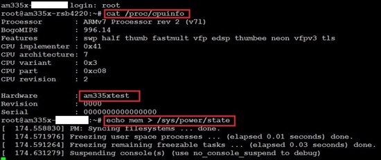

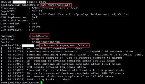

  • Hi Bin,
        Sorry, the problem is still there
    Following shown:
    Code changes before:
    After code change:
  • Ryan,
    After recreated a fresh test environment, I am able to replicate the issue. For some reason, after machine name changed, 'cputype' command generates non-linefetch abort which causes pvr-init script failed to initialize. Please try the following patch for the root filesystem to see it works around the issue for you.
