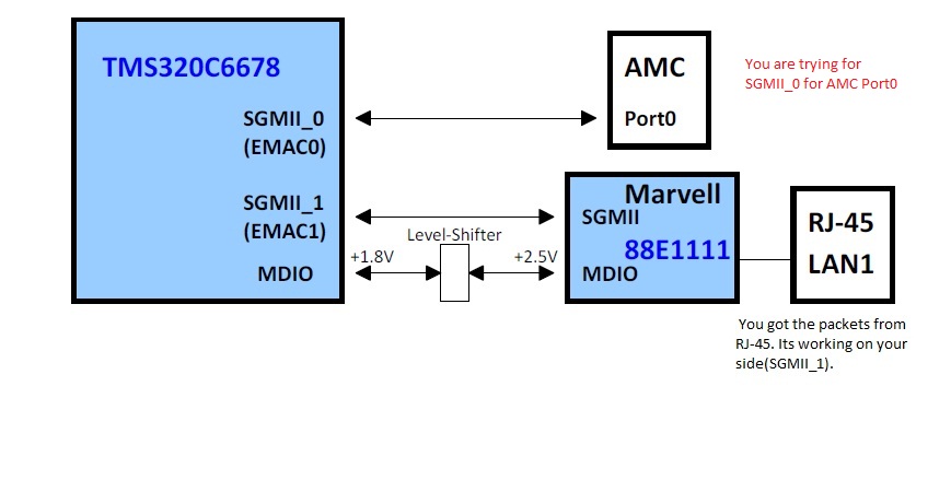

C6678 ethernet port 0 won't transmit packet
Good day!
I'm working with EVM6678 board and I'd like to use it in AMC chassis.
I've edited nimu_eth.c to support EMAC port 0 (which is routed to AMC) instead of EMAC port 1 (which is routed to on-board PHY):
    ethInfo.inport = pa_EMAC_PORT_0;  in EmacStart() function
and
        gTxPort = EMAC_PORT_USED; in EMACInit_Core() function.
I call InitSGMII() function for port 0 after platform_init() function call.
I create a UDP socket and send 1KB data using EMAC port 0, but packets aren't sent (EmacSend() function in NIMU driver aren't called)
I've tried all settings described in http://e2e.ti.com/support/dsp/c6000_multi-core_dsps/f/639/t/196772.aspx, http://e2e.ti.com/support/dsp/c6000_multi-core_dsps/f/639/t/266546.aspx and http://e2e.ti.com/support/dsp/c6000_multi-core_dsps/f/639/t/278528.aspx posts, but it's still not working.
Have you any ideas?
  • Update:
    Code which tscheck is posted in http://e2e.ti.com/support/dsp/c6000_multi-core_dsps/f/639/t/278528.aspx (http://processors.wiki.ti.com/images/1/11/EVM_EMAC0_en.zip) is not working too.
    Refer this E2E thread,If you are connecting SGMII-to-SGMII through an AMC setup
    http://e2e.ti.com/support/dsp/c6000_multi-core_dsps/f/639/p/196299/700615.aspx#700615
    http://e2e.ti.com/support/dsp/c6000_multi-core_dsps/f/639/t/115240.aspx
  • Hi Pubesh!
    I've checked the post you've pointed, but none of them helps me. The physical connection for SGMII0 is established, link is up, negotiating is completed, no errors, 6 packets of 64 bytes each are sent from SGMII0 to link partner (I read it from STATSA and STATSB registers).
    But my packets which I send using UDP socket at this port doesn't even reach NIMU driver EmacSend() function! And the same code for port 1 connected to on-board PHY works without problem!
    If possible please provide a code snippet so that we can examine this issue.
  • Hi Pubesh!
    Here are my client example source code and NIMU source code I've edited.

    You shared minimal code only, from that I could not find the serdes configuration(configSerdes()).
    This function is used from the platform lib normally. Can you provide the full set of project to analyse the issue.
    Please conform my understanding is correct from the below snapshot.
    Did you probe the AMC pins for the following signals at: AMC0_SGMII0_TX_DP, AMC0_SGMII0_RX_DP and AMC0_SGMII0_TX_DN, AMC0_SGMII0_RX_DN.
  • Hi Pubesh!
    Serdes are configured by board evm6678.gel GEL file for both ports. Your snapshot is correct, I'm trying to send packets through SGMII_0 to link partner, SGMII 0 is configured in forced link configuration and has link up. Here is the working project to test the case: 1067.client.zip
