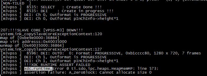

Hi all:
   Our platform is dvr4.1, now i add NVRSOURCE_04.01.00.02.tar to it,after uncompressd  I found ther are no indication of this  addition bag.
 Then I search it on http://processors.wiki.ti.com/, It is still no information about it.
 Is there have some references about it.? Or give some indication for using or searching..tks very much!
 I compile it and running  commit a lot of errors: for example:
  • NVRSOURCE is source code for NVR GUI application.It has nothing to do with the assert you are seeing. The assert you are seeing is due to wrong application configuration. It looks like DEI output width/height is set to 0 x 0 .This is mostly because prevLinkId is wrongly set for DEI.
