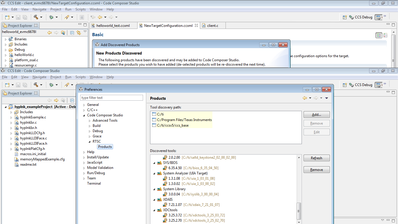

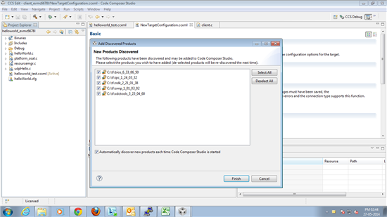

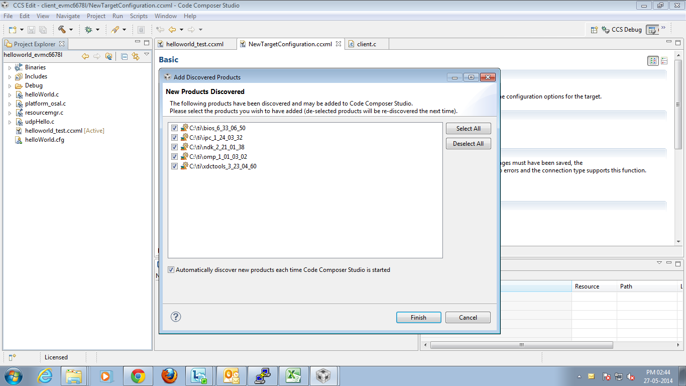

  • Hi
    I've installed MCSDK but when i try to import the Hyperlink example project i get some errors
    Unrecognized product of type 'com.ti.sdo.edma3' is required by project 'hyplnk_exampleProject' - please install at least one product of this type before building this project.
    Unrecognized product of type 'com.ti.rtsc.IPC' is required by project 'hyplnk_exampleProject' - please install at least one product of this type before building this project.
    Unrecognized product of type 'com.ti.biosmcsdk.pdk.C6657' is required by project 'hyplnk_exampleProject' - please install at least one product of this type before building this project.
    From my understanding, You have not re-started the CCS after MCSDK installation or not installed the MCSDK in default installation directory. Due to which the CCS not recognized the products installed on it.
    Our recommendation is to install all the packages on default installation directory. The new products discovered page will look like below.
    Please add tool discovery path and refresh the discovered tools from Window->Preferences->CCS->RTSC->Products.
    Thanks.
