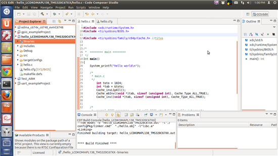

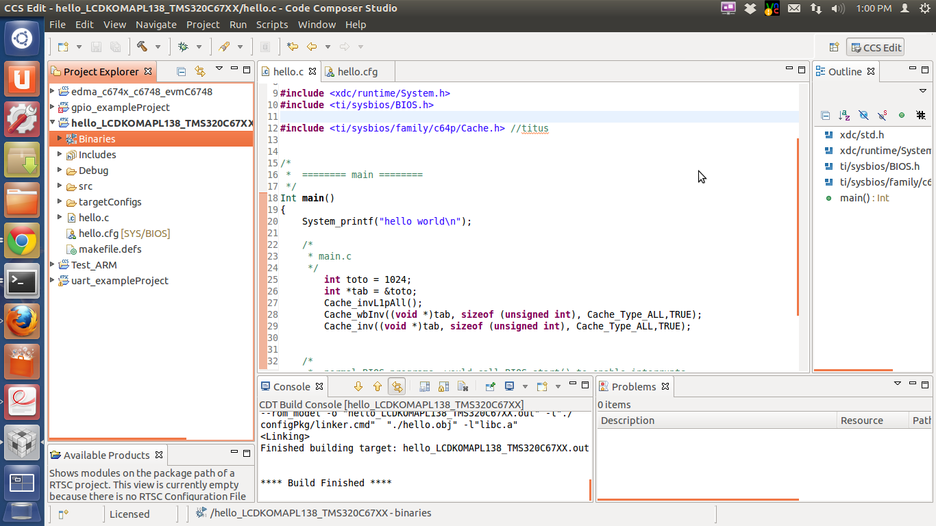

    I currently work with OMAP-L138, and I try to compile my project_test which it use 3 functions :
    Your project seems to be  SYSBIOS which is required proper sysbios build options settings.
    I have imported one sample"hello" SYSBIOS project from "TI project explorer" and copied your code into it and I got successful build.
    I suspect that the improper build & link options of project could be the reason for your build issue.
    Please try the same and let us know the results.
    PFA of screen shot of successful build with your code (#include <ti/sysbios/family/c64p/Cache.h>).
