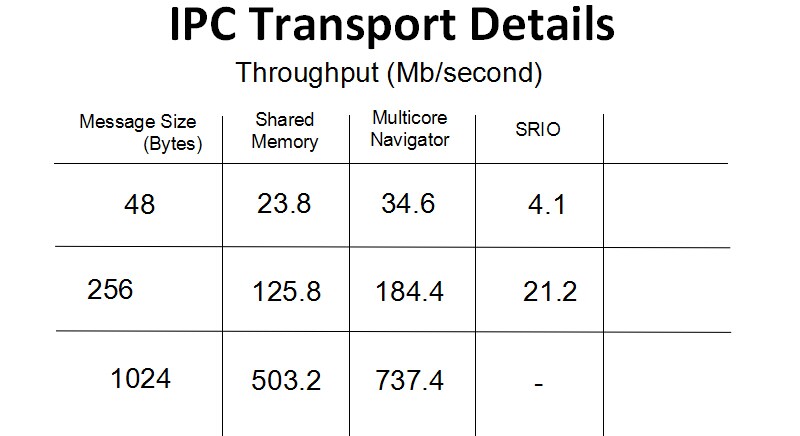

hi
but The qmssIpcBenchmark project runs,the log is:
Average 1-way latency:              3524 (cycles/msg)                 3524 (ns/msg)   //after caculate: 283766msg/s   13MB/s
Throughput via upfront allocation: Allocate all messages up front, sync cores, send all messages from core 0 to core 1
[C66xx_1] Core 1. msgs Received= 8000 time=10377808 (cycles - 10377 us). thrput=770935 [msgs/s]   //after caculate 35MB/s
cycles/msg = 1297
i want to know the picture downloaded  from internet,the Mb/s is a error,it should be MB/s,is it?
