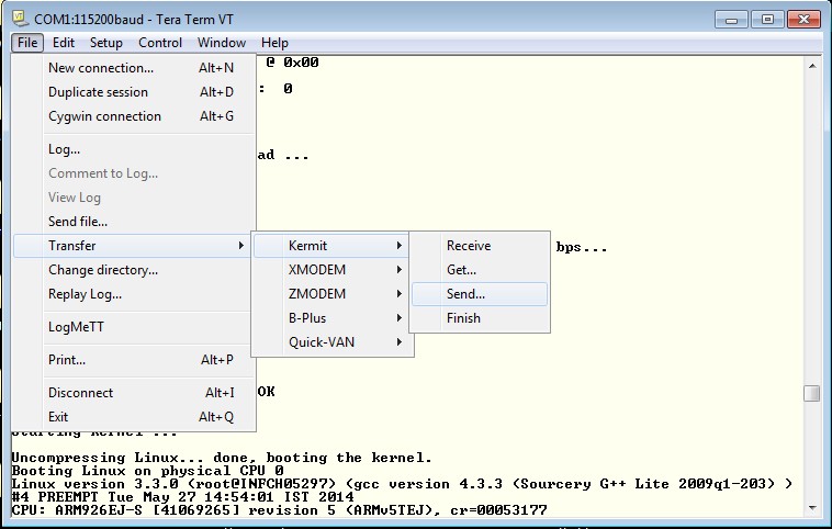

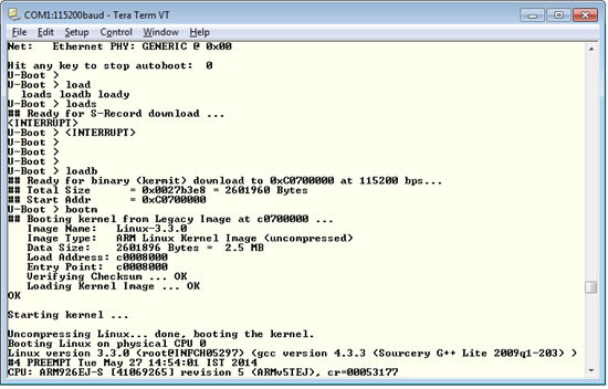

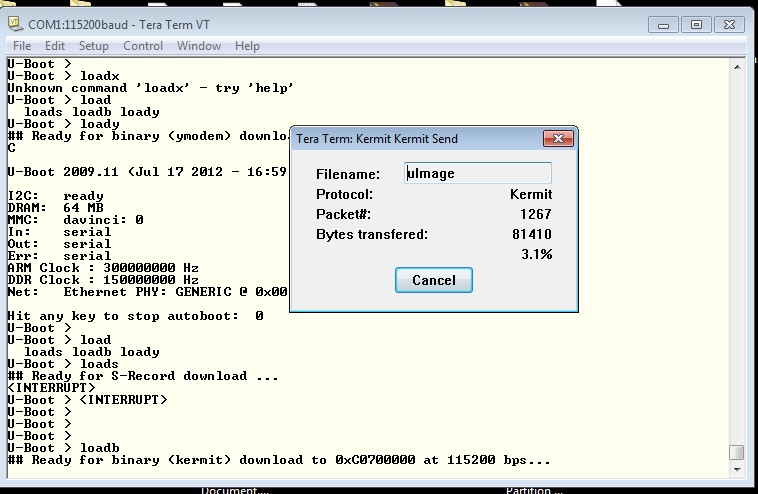

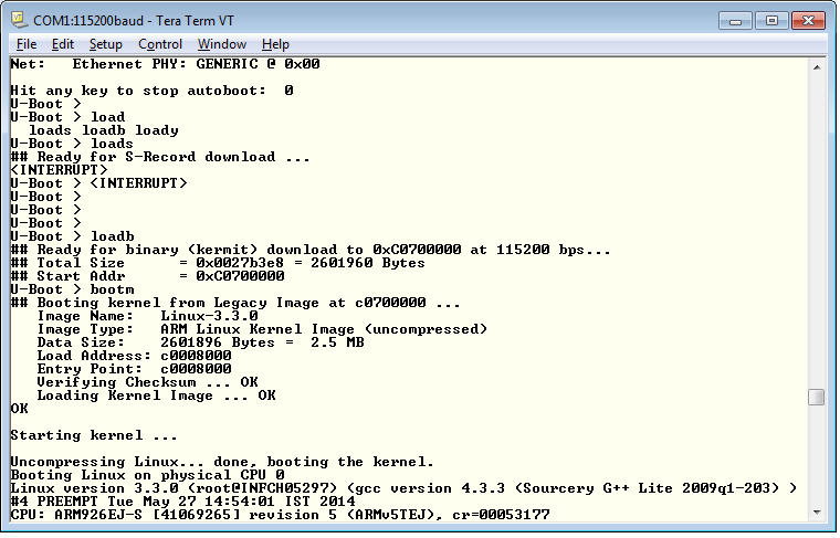

    Just try with "tera term" also.
    I'm able to load kernel image through kermit.
    1) Give "loadb" command in u-boot
    2) In turbo term, Select "Transfer" option and choose kermit option to tranfer the "uImage" to the board.
    PFA of screen shots.
    Please try this and update the results.

    loadb
    ## Ready for binary (kermit) download to 0xC0700000 at 115200 bps...
    ## Total Size      = 0x00249677 = 2397815 Bytes
    ## Start Addr      = 0xC0700000
    U-Boot > bootm 0xc0700000
