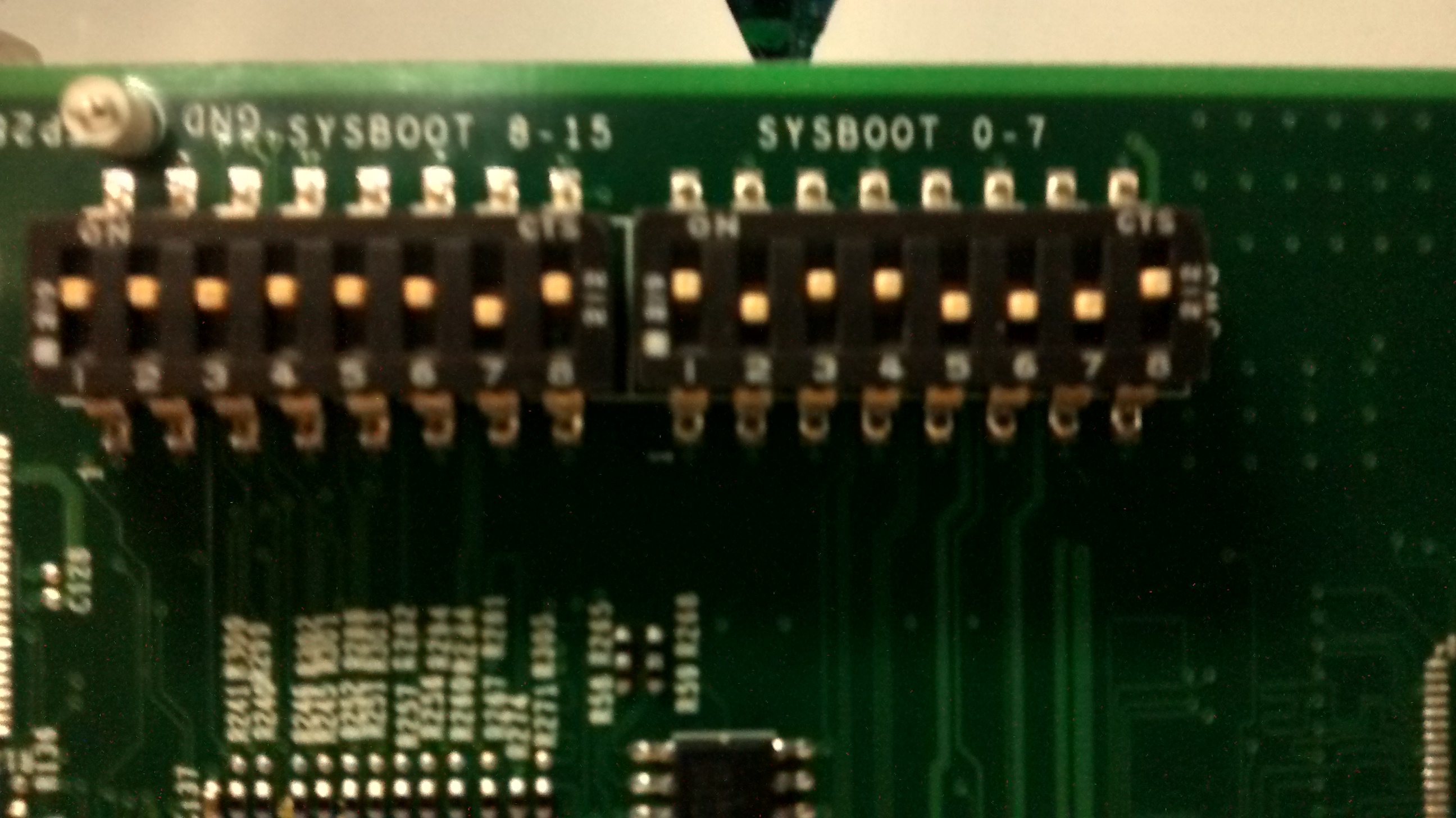

    3. I switched off the EVM and made these switch positions,
    4. I switched on the board, got ccccccc, what change should I make for uboot to come up on NAND Flash.
    Gangadhar
  • Gangadhar, it is really hard to follow your steps when you have so many variables.
    Please first try to do it with the simplest set of commands and once you get it working, you can write a command to do it.
    Please follow my steps I posted in my previous post, replacing the "fatload" commands with the corresponding "tftp" commands.
    Miroslav
  • Thankyou Miroslav. It's working.
    Gangadhar
