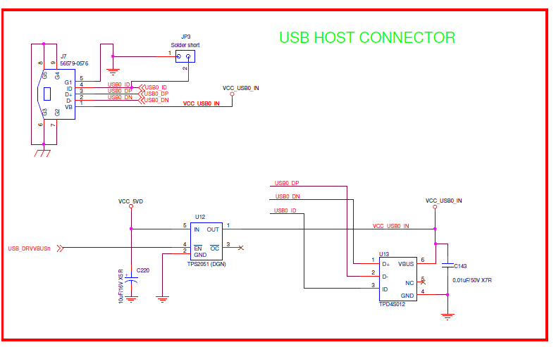

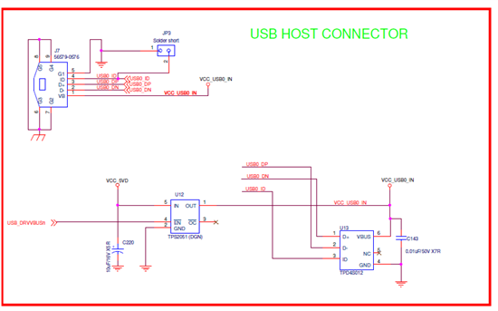

    We have custom AM1808 device and i need to enable the USB2.0 in peripheral mode but there is no initialization part in board file.
Please let me know what is the procedure to activate USB2.0 as peripheral mode which means i just want to connect the device with PC.
1.Schematic
2.Board file
3.Kernel driver config
M Sangly

  • Hi
    But the board file board-omapl138-hawk.c doesn't have any initialization part for USB2.0 its just initialized USB1.0 so what are the register(cfgchip2) to be modify for USB2.0 and tell me the procedure for edit board file.
    Could you please tell me that what is the reference board (LCDK or SDI EVM or LPD EVM)  for your custom ?
    I hope it is LCDK, Please correct me if I'm wrong.
    Please refer the below file and modify your LCDK board's file according to your requirement.
    "arch/arm/mach-davinci/board-da850-evm.c"
    Refer the following TI wiki for OTG.
    http://processors.wiki.ti.com/index.php/UsbSoftwareInterface
    Try to append the below code in your board file and let us know the results.

  • Hi
           Its working fine for HOST only mode with "USB0_ID" pin grounded, But its not working in peripheral mode with  "USB0_ID" pin floating.
    When i try to connect the USB with PC i'm getting following error log
    root@omapl138-lcdk:/# Unable to handle kernel NULL pointer dereference at virtual address 00000004
