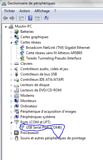

When i test if the board is detected i don'i see bootme in the terminal :
I plug the mini usb into the board in J3 and the other usb into pc.
I make dip switches to run with mode uart 0101
i unplug the power
I choose the serial usb in teraterm ans i set the baud rate. when i plug the power i don' see in the terminal BOOTME.
No thing is work in the dsp : I didn't succed to run it as TI said in the quick start demo. I can't doo boot fash. ansd the xds100v2 say that we have no power in the board. if unplag power pour i plug it i have the some message ( turn on the power)
Ay idea??
Thank you
What is your host machine (PC)?
windows or linux ubuntu ?
If windows, You need driver (FT232) to get detect console, and After installed the driver, Check which COM port has been detected through "Device Manager"
If linux, You will get "/dev/ttyUSB0" node and open minicom with "/dev/ttyUSB0"
The some problem no boot. XDS100V2 don't detect theboard. The demo didn't run
I'm confused, How about "BOOTME" message while you setup UART boot mode?
Fixed or not !
Are you getting "BOOTME" message from USB-UART console?
