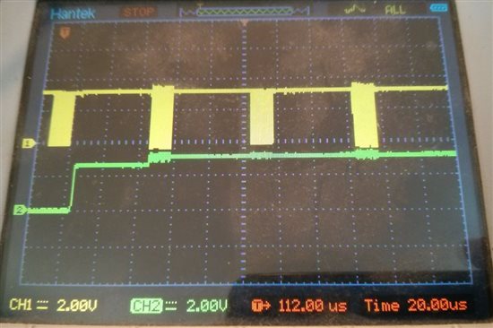

Hello All,
I am using LogicPD Omap L138 SOM on a custom board, SysBios 6.34.2.18, XDCTools 3.23.5.61, StarterWare 1.10.03.03.
I try communicating with a sensor trough SPI1 over the ARM9 core:
1. Pinmux is configured correctly (PINMUX4 = 0x01000000, PINMUX5 = 0x00110100)
2. CS 3 is used
3. SPI Freq is 350KHz
4. Char length is 16bits, MSB first, Polarity HIGH, Phase LOW (As the sensor DS requires).
I have some problems:
1. SOMI line is LOW when no data is transferred but when data is transferred it is pulled HIGH (I can see some data higher than the flat line). I looked into LogicPD SOM schematics also in my custom board and couldn't find any interference.
2. Why do the processor send ~64 clocks for 2 bytes of transferred data? (Shouldn't it be 16 clocks for send and 16 clocks for receive?).

  • No idea what you are seeing 64 clock pulses. Your code, with ReadData() len=1, should result in SPITransmitData1() being called once with a result of 16 clock pulses. Seeing 64 clock pulses implies that SPITransmitData1() was called 4 times.
    Th SOMI line should always be an input to the processor. Perhaps there is pull up resistor somewhere and slave is not capable of pulling it down.
    A programming note, your word is 16-bit. Perhaps tx_data, rx_data, p_tx and p_rx should be 16-bit types.
    SPI sends and recieves simultaneously. Is the slave sending back on the first 16 clock pulses?
  • The slave should not send data on the first word.

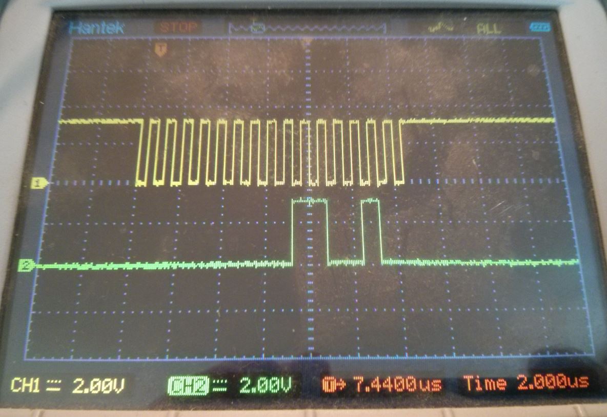

    I don't have a clue why is sending so many clock pulses, I even probed the SPI1_CLK line with a scope when I put the data on the SPIDAT1 register so it must be on a single transmit call. I'll change the types to short but I don't think it matters when the drivers receive unsigned int...
    Am I the only one with this wierd behaviour?
  • Not much to add. Mystery to me. Just a side not. The prescaler can only be 8-bits.
    decirted prescale = 150000000/350000 - 1 = 427.57 = 427 = 0x1AB
    actual prescale = 0xAB + 1 = 0xAC = 172
    actual clock = 150000000/172 = 872093

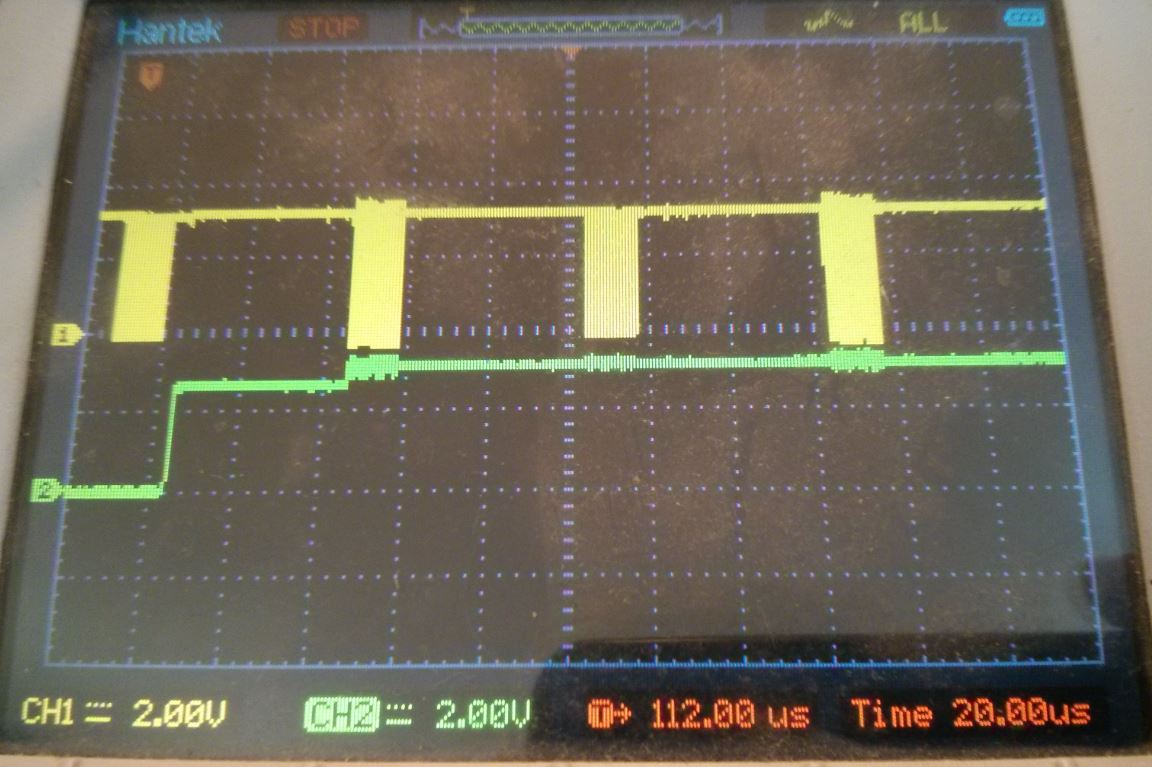

  • Well, Inspite of Norman's help the problem remains.
    I did change the SPI freq to 1MHz because of the prescale overflow as norman suggested but there are still 2 main issues which I would be happy if someone from TI would step in and help:
    1. Every call to "SPITransmitData1" generates 64 clocks on the SPI1_CLK line.
    2. SPI1_SOMI line I somehow pulled to 2.8V when slave sends data (the data is at 3.3V but it is masked with a 2.8V signal), There is nothing that pulls up the line on my board nor the LogicPD som (assuming the SOM schematics are correct).
    I really need this problem fixed fast and I ran out of options.
    Yoel
  • The SPI pins, by default, all have Internal Pullup (IPU) resistors. Perhaps the slave is not strong enough to pull down the line. Yeah, unlikely.
    Can you post the current version of your test code? A thing to verify is that you initialized the transmit buffer for the entire transaction. For example, if you tx 1 byte then rx 1 bytes then you have to init 1+1=2 bytes of the tx buffer and look at the 2nd byte in the receive buffer. The SPITransmitData1() function does not mask the data argument. Any data over 16 bits will write into the control portion of SPI_SPIDAT1.
  • Hey Norman,
    The pull up doesn't happen in SPI0 so I don't think that is the reason (unless the pullups there are much smaller).
    I couldn't find a way to explicitly tell the SPI how many bytes to send for each transaction (only the word length) and I probe the SPI_CLK only before and after the "SPITransmitData1(SPI_BASE, *p_tx)" command, so it only suppose to send one word and receive one word, that is 32bit.

    Unfortunately, the problem with the SOMI line pulled high remains, I don't have a clue what is pulling it, with the SPI slave evaluation module it works great...
    Here are some images from my scope:
    SOMI line (relative to SCLK):
    SIMO line (relative to SCLK):

  • By the sounds of everything is working except for the pull-up glitch? But even with the pull-up glitch, your are communicating with the slave?
  • I can't get data from it but it looks like it can hear my voice... (It seems like SIMO line works but all I get from SOMI are 0xFFFF)
  • What is the slave expecting? What is the message protocol? The StatusGet() function does not initialize p_tx or tx_len. After the first 0, you might sending undefined data of undefined length.
    EDIT: I missed that TX interrupts are not turned on. Just one zero value should be sent.
  • The protocol is as follows:
    Master sends 0x64 to slave.
    Slave then initiates the trigger, 16K data length when every 2 bytes are signaled (That is why in GPIOIsr I call the StatusGet() which needs to read only 2 bytes.
    What I see in the SOMI line is that the data is sent (3.3V) but it is masked by 2.8V from somewhere else, Nothing is connected on that line on my board and I can see only the SPI Flash connected on the LogicPD SOM.
