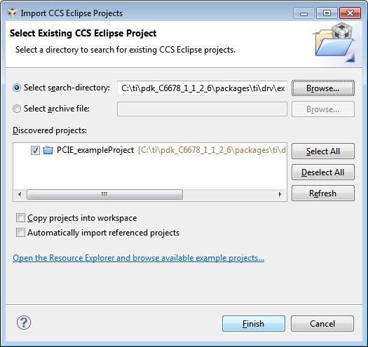

Hi Victor,
Following the below steps to build MCSDK PCIe example project. The procedure assumes the MCSDK is installed in C:\ti.
1. Open CCS (preferably with a new workspace)
2. Goto Project->Import Existing CCS Eclipse project
3. In the Select search-directory: enter C:\ti\pdk_C6678_1_1_2_6\packages\ti\drv\exampleProjects\PCIE_exampleProject and hit Browse.
4. Make sure the Copy projects into workspace is not checked. Then hit Finish.
5. Right-click on the project in Project Explorer and select Build Project
6. CCS will now attempt to compile and link the project. This may take a few minutes to complete.
7. Please direct your attention to the CCS Console. On a successful build, you will see no errors generated in the Problems window (NOTE: There may be warnings) and the following message should display in the Console window:
'Finished building target: SRIO_LoopbackDioIsrexampleproject.out'
**** Build Finished ****

Hi Ganapathi,
thank you for your quick and clear reply.
Example works as you wrote.
Viktor.
