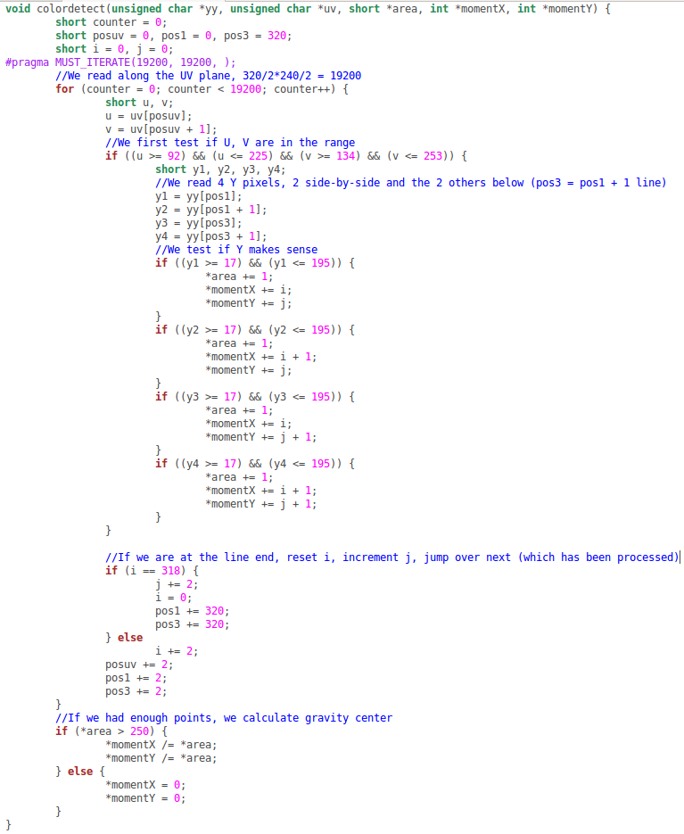

I'm running a relatively simple threshold function for  a 320x240 NV12 image on a DSP C64x+. I have read the various optimization recommendations and I have tried to optimize as much as possible but the performance is still disappointing. The code looks like the following:
(I insert an image so that it's possible to read it more clearly)
Is there any other recommendation? Am I missing something obvious?

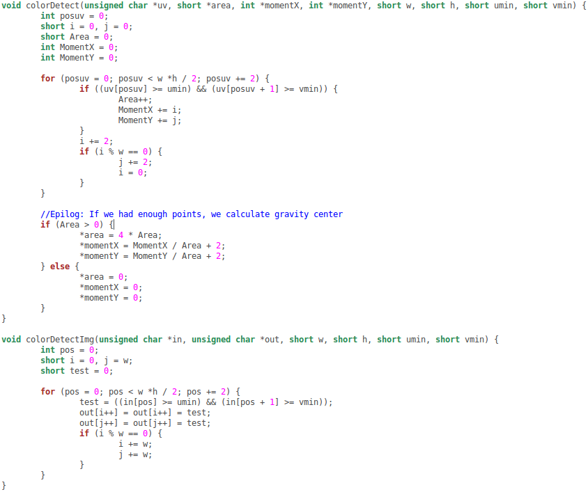

  • I have made some progress but I'm still not satisfied.
    I have read and I'm continuously reading all the resources and try to do "similar" things.
    I'm using the following compiled flags: -on2 -o3 -mt -s -al -mw and I have discovered the lst file which is very handy.
    Thanks to Andy, I have seen one improvement which loop is not any more disqualified for pipeline after removing the % which was indeed the external call.
    The code looks like this now:
    I have also another version without if but the performance is exactly the same.
    Nevertheless, the performance is still not so great. It takes around 40~50ms while the VLIB Pyramid8 API takes 10ms. I compare to this API because the job seems quite similar.

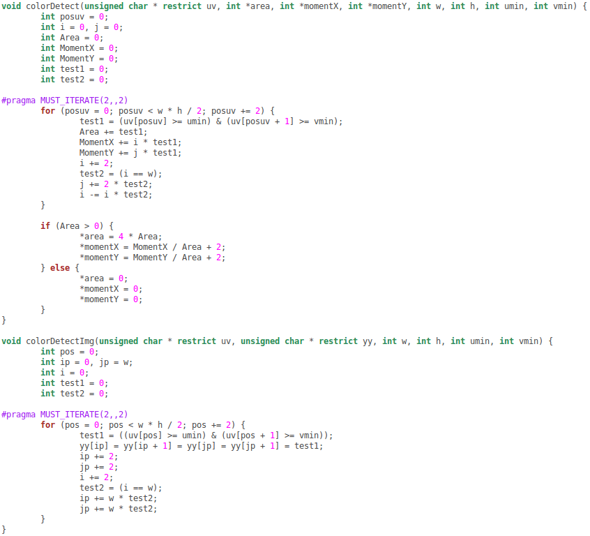

  • Don't use multiply, stick to if. There is no (shouldn't be) actual branch in generated code, instead instructions are predicated, which is more efficient.
    There is no SPLOOP generated. Do you use -mv6400+?

    Why are you mixing boolean and numerical values? I doubt that the compiler is constrained to only evaluate a boolean to 0 or 1, but maybe I am wrong about that. I would have expected a warning to be generated for this, where you test1 in math operations.
    I am not sure I agree with replacing && with &. I would have tried copying the two pixel values to temporary variables then testing with those variables. But the right solution is whatever gets you to fewer loads and faster performance.
    You should use #nassert to tell the compiler about the starting address of the arrays. You will find examples in the training materials and the compiler documentation.
    You should try the unroll pragma to get to at least a single LDW read for every pair of passes through your loops. If you have LDB's in there, you are wasting a lot of time.

    Good news! I have reached my goal. Based on Jesse comment, I have taken a look at imglib which source code is available. There are a couple of APIs very similar: threshold and boundary. The key gain comes from using:
    _cmpgtu4(_amem4_const(&uv[i]), threshold);
    and also unrolling x4 the loop.
    I didn't know the "insert code", and I was doing image for clarity of indentation. I will definitely use that the next time.
    I'm now at 10ms which starts to be acceptable. It was not an ego quest ;-). I'm at 50fps so the initial 50ms / frame was not acceptable.
    For the records, I'm parsing a NV12 frame so it's why I have 1/2 in a few places.
    To fully recap, the first thing was to add the right set of flag, then analyze the LST file and then leverage the intrinsics. The next step would be to write everything in assembly. There is another sample in the imglib source code but I'm not too proficient in assembly.
