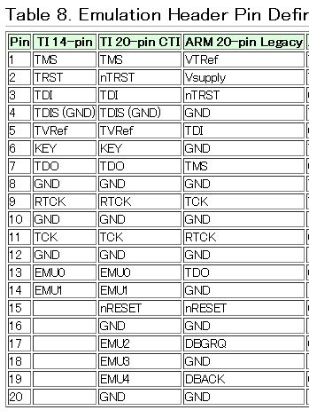

I have a question about XDS100v2 emulator.
I ordered XDS100v2-ARM for AM3357.
First, I want to know the signals of XDS100v2-ARM.
In following TI wiki, there are 3 header pin definition for ARM Header. http://processors.wiki.ti.com/index.php/XDS_Target_Connection_Guide#Table_8._Emulation_Header_Pin_Definition
Which header are appropriate to XDS100v2-ARM?
ARM 20-pin Legacy or ARM 20-pin Cortex+ETM?
My target device is AM3357 and I'm confused that how to layout the JTAG signal to the header.
Should I layout the JTAG signal as TI 20-pin CTI and use adaptor to connect to the XDS10v2-ARM?
If yes, which adaptor should I use?
