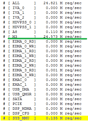

    after DM8168 being load ok,  we use mem_stats.out tools to show memory usage,  and we get:
    it seem that M3 consume too much bandwidth.  we do the following test to find the reason:
a) Is the video-m3/vpss-m3's code/data/stack cacheable ?
    [result]:  we check the AMMU_m3.cfg,  it already configure cacheable;
b) we force set the video-m3/vpss-m3 in exceptions (by read memory address: 0xffff0000)
    [result]:   M3 req/sec reduce to 0;

  • As mentioned by the FAE the M3 idle loop will do load calculation and also if all tasks are blocked bios will execute a simple counter increment . The M3 cache is configured for write thru so you will see a large number of DR transaction from M3. This number will change when M3 is really loaded. The req/s doesn't reflect the DDR badwidth usage.It only reflect number of DDR requests. The actual DDR bw should be measured using CCS based stats collector module.

    Note that as mentioned before even though you see a large number of requests the actual DDR bw is insignificant and even if there are large number of DDR req/s from m3 it doesn't affect system performance.
