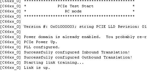

I'm using TMDSEVM6657LS in a Blue-Ema uTCA chasis with a Nat-MCH-PCIE-GEN3,when i plug the EVM board to the slot which is used for RootComplex  it can be identified by mch, but when i use mch's  command to see the ekey status,it only have Ethernet's output.
when i plug EVM to any other slot which is for downstream,Ethernet and PCIE  status can be printed .
I already have SW5.3  off to have backplane clock. and download the PCIE-example project to the dsp ,and set PCIE mode to RC.  I only use ccs5to debug with xbs200 emulator,i guess that means i successfully download the code to DSP.
Do I miss something that will cause that problem?

  • Hi Gannapathi,
    1. I only let sw3.1  and sw5.3 be off, and in my ccs folder there are mcsdk_2_01_01_04  and pdk_c6657_1_1_1_4
    2.I still can't see the ekey in mch's debug view,but in ccs it shows link is up
    I don't know if this means EVM work properly for pcie?

  • Hi Ganapathi,
    I know the example project is used for two EVMs, but I think the code can be modified to apply more complicated situations such as one EVM for RC and FPGA for EP.I saw many posts about that.
    Right now I only plug one EVM into the utca  chasis,and the output shows "link is up" .Does that mean the EVM detect the PCie switch on the MCH?
    And if I plug one more board such as another EVM as EP and both boards show "link is up",can i assume that they can exchange data with PCIE?
