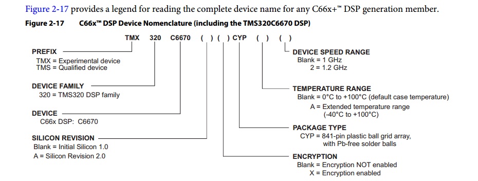

The part number is TMS320C6670ACYPA2.
Could someone confirm that the Security Accelerator (SA) is pre-enabled on this device?
Thank you,
Edwin Lee
  • Edwin,
    The Security Accelerator function is subject to export control and will be enabled only for approved device shipments.
    The Security Accelerator is coupled with network coprocessor. For more information, see the Security Accelerator (SA) for KeyStone Devices User Guide and Datasheet.
    http://www.ti.com/lit/sprugy6
    http://www.ti.com/lit/ds/symlink/tms320c6670.pdf
    See this E2E post, will be helpful for C66x™ DSP Device Nomenclature
    http://e2e.ti.com/support/dsp/c6000_multi-core_dsps/f/639/p/232274/815433.aspx#815433

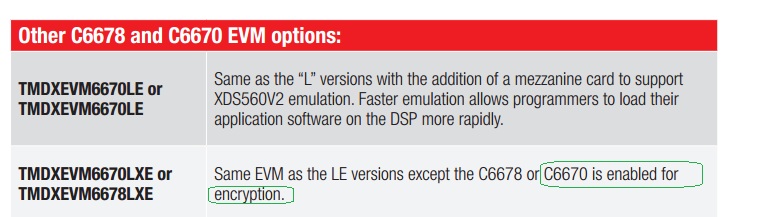

    Supported EVM's:
    In addition, go through the product link,
    http://www.ti.com/product/tms320c6670
    http://www.ti.com/lit/ml/sprw240/sprw240.pdf
